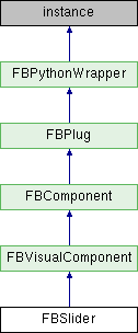

Inheritance diagram for FBSlider:Public Member Functions | |
