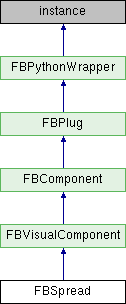

Base spreadsheet class.
Inheritance diagram for FBSpread:Public Member Functions | |
