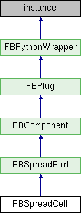

Inheritance diagram for FBSpreadCell:Public Member Functions | |
