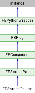

Inheritance diagram for FBSpreadColumn:Public Member Functions | |
