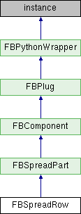

Inheritance diagram for FBSpreadRow:Public Member Functions | |
