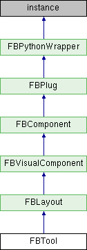

Inheritance diagram for FBTool:Public Member Functions | |

| __init__ | ( | object | arg1, |
| str | arg2, | ||
| object | arg3 | ||
Python Docstring:
__init__( (object)arg1, (str)arg2 [, (object)arg3]) -> None
C++ Constructors:
The reference documentation for the following C++ symbols may contain additional relevant information.
| __reduce__ | ( | ) |
| FBToolPossibleDockPosition GetPossibleDockPosition | ( | FBTool | arg1 | ) |
Get the possible docking position for the tool (concatenated).
Python Docstring:
GetPossibleDockPosition( (FBTool)arg1) -> FBToolPossibleDockPosition
C++ Signature:
FBToolPossibleDockPosition GetPossibleDockPosition()
| SetPossibleDockPosition | ( | FBTool | arg1, |
| FBToolPossibleDockPosition | arg2 | ||
Set the possible docking position for the tool.
Python Docstring:
SetPossibleDockPosition( (FBTool)arg1, (FBToolPossibleDockPosition)arg2) -> None
C++ Signature:
void SetPossibleDockPosition(FBToolPossibleDockPosition pFlags)
Be sure to call this function once the tool is visible, a good place to call it is when the OnShow event of the layout is called.
| pFlags | Set the docking position flag values. Note: this function overwrites all flags with those passed in parameter. |
| MaxSizeX |
Read Property: (int) Maximum Size in X (Disabled in this version). A value of -1 means no maximum size.
| MaxSizeY |
(int) Maximum Size in Y (Disabled in this version). A value of -1 means no maximum size.
| MinSizeX |
Read Property: (int) Minimum Size in X. A value of -1 means no minimum value.
| MinSizeY |
Read Property: (int) Minimum Size in Y. A value of -1 means no minimum value.
| StartPosX |
Read Property: (int) Starting Position in X. This is the initial position when the tool is opened. Default = 450
| StartPosY |
Read Property: (int) Starting Position in Y. This is the initial position when the tool is opened. Default = 450
| StartSizeX |
Read Property: (int) Starting Size. This is the initial size in X when the tool is opened. Default = 800
| StartSizeY |
Read Property: (int) Starting Size. This is the initial size in Y when the tool is opened. Default = 400
| ToolName |
Read Property: (str) Tool Name
