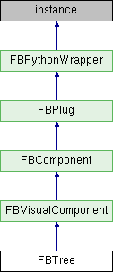

Inheritance diagram for FBTree:Public Member Functions | |
