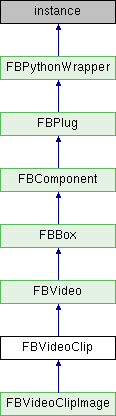

Inheritance diagram for FBVideoClip:Public Member Functions | |
