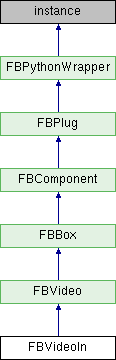

Basic video input class, supporting webcam and DV device.
Inheritance diagram for FBVideoIn:Public Member Functions | |
