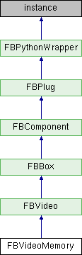

この参照ページは、次の概要トピックと関連付けられています。#include <mobu-python-api.h>
FBVideoMemory allow external media source (which can't be supported by MoBu natively)
User could create / update OGL texture (GL_TEXTURE_2D type) externally, and pass in GL texture object id to TextureOGLId property. See "Scripts/Samples/Video/VideoMemory.py" for usage example.
Inheritance diagram for FBVideoMemory:Public Member Functions | |
| __reduce__ () | |
| __init__ (object arg1, str arg2) | |
| Constructor. More... | |
| SetObjectImageSize (FBVideoMemory arg1, object arg2, object arg3) | |
| Set image size to allow MoBu preview texture with proper dimension / aspect. More... | |
