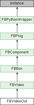

#include <mobu-python-api.h>
Video media class.
Inheritance diagram for FBVideoOut:Public Member Functions | |

Public Member Functions inherited from FBVideo | |
| __reduce__ () | |
| __init__ (object arg1, str arg2) | |
| Constructor. More... | |
