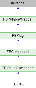

Generic view.
Inheritance diagram for FBView:Public Member Functions | |
