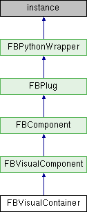

Used to create a container for a tool UI.
Inheritance diagram for FBVisualContainer:Public Member Functions | |
