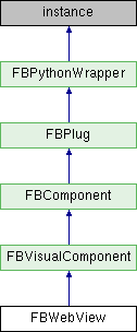

Inheritance diagram for FBWebView:Public Member Functions | |
