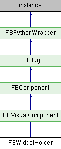

Inheritance diagram for FBWidgetHolder:Public Member Functions | |
