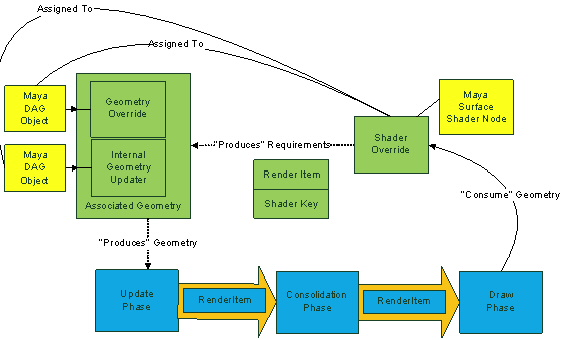

At a high level, MPxShaderOverride has two main tasks. It specifies the geometry streams it needs to draw (geometry requirements) and then it draws objects to which it has been assigned. This demonstrates the producer-consumer relationship of the new rendering model. This class produces geometry requirements (MGeometryRequirements), which are consumed by the geometry system (internal class or plug-in implementations of MPxGeometryOverride) in order to produce geometry streams. Then, the draw method of this class consumes the geometry streams in order to draw.
Figure 41: A sample configuration of a shader override assigned to two different DAG objects. One DAG object is using a geometry override. The other is using an internal geometry updater. This configuration can be an example of a NURBS surface updater. The shader override “produces” requirements for each updater. Each object “produces” new geometry to render. This geometry is passed down the pipeline in the associated render items until it is “consumed” by the shader override.
The three main phases that the override must implement are initialization, update and draw.
The phases of MPxShaderOverride are triggered for execution when an instance of the associated shader type is bound to an object or when the input attributes of the shader itself change. No special logic needs to be added to trigger an update. The update methods that are called depend on the type of change that occurs. New assignments of the shader trigger full rebuilds. Similarly, if rebuildAlways() returns true, then an attribute change also triggers a full rebuild. In all other cases, initialization is skipped and only update will occur. The draw phase happens on every refresh where the shader needs to draw an object.
During the initialization phase, the geometric stream requirements can be specified using addGeometryRequirement(). The requirements specify the geometric streams that are required from objects to which the given shading effect is assigned. If no requirements are specified, then a single position stream requirement is used. The initialize() method must return a string representing the shader key. It often happens that different instances of the MPxShaderOverride represent essentially the same shader, but with different shader parameters. The shader key is used to identify the MPxShaderOverride instances representing the same shader. To optimize rendering, the renderer makes an effort to consolidate the rendering of objects based on the properties returned from the MPxShaderOverride. This includes the shader key, but can also include other factors. Refer to Consolidation considerations below for further details about consolidation and geometry handling. This allows the plug-in to perform its setup only once for the entire sequence. It is the responsibility of each plug-in to decide on the meaning of representing the same shader.

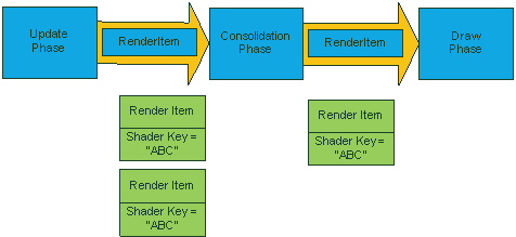

Figure 42: The shader key provided by the shader override can be the same for two render items. In this case, consolidation may “merge” these items into a single render item before drawing occurs.
During initialization, if the current display mode is non-textured display mode, an internally defined static shader instance is used for all render items that use the shading node associated with a given shader override. This is a performance optimization to avoid any additional node monitoring, as well as to allow render items that share this shader instance to be consolidated.
To override this behavior, the MPxShaderOverride::nonTexturedShaderInstance() method can be overridden to return a custom shader instance instead of the default shared instance. A return parameter can be set to indicate if this shader instance needs to be updated upon node attribute changes. If no monitoring is required, then Maya will attempt to skip the update phase while in non-textured mode. It is possible that an update is still required for the shader that is used for textured mode display. For example, if MPxShaderOverride::rebuildAlways() returns true, then the update phase would be called regardless of the options set with this method.

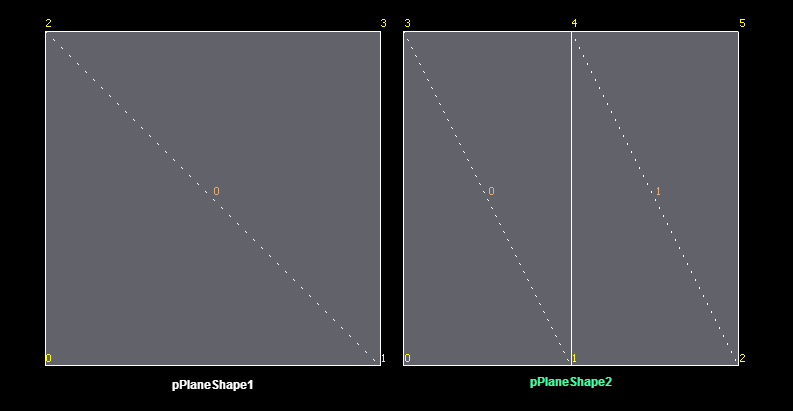

} For a concrete example, consider a scene with two objects: pPlaneShape1 and pPlaneShape2, which are assigned the same plug-in shader (hwPhong). The image shows the topology (vertex and faces ids) for each object. Triangulation is shown with dotted lines.

} In the case where consolidation is possible between the two objects, the returned information is shown below. Plain text and bold are used to show how the indices are related to the original objects. Bold is used to indicate pPlaneShape1.
Indexing Primitive Type = Triangles,
Index type = Unsigned Int 16,
Index count = 18
Index array:
index[0] = 0
index[1] = 1
index[2] = 3
index[3] = 3
index[4] = 1
index[5] = 2
index[6] = 4
index[7] = 5
index[8] = 7
index[9] = 7
index[10] = 5
index[11] = 6
index[12] = 8
index[13] = 9
index[14] = 11
index[15] = 11
index[16] = 9
index[17] = 10
The consolidation information provided for the geometries indicates that:
The first geometry has path=|pPlane2|pPlaneShape2, with an index start=0, and index length=12. This indexing is longer since we have two quads (or 4 triangles) in this geometry.
The second geometry has a path=|pPlane1|pPlaneShape1, with an index start=12, and index length=6. This indexing is for the single quad (2 triangles).
Note: 16-bit indexing (unsigned short) can be returned when geometry is consolidated, versus 32-bit indexing.
The following is the result of a dump of the vertex and face identifier information:
vertexid[0] = 0.000000 | faceid[0] = 0.000000 |
| vertexid[1] = 1.000000 | faceid[1] = 0.000000 |
| vertexid[2] = 4.000000 | faceid[2] = 0.000000 |
| vertexid[3] = 3.000000 | faceid[3] = 0.000000 |
| vertexid[4] = 1.000000 | faceid[4] = 1.000000 |
| vertexid[5] = 2.000000 | faceid[5] = 1.000000 |
| vertexid[6] = 5.000000 | faceid[6] = 1.000000 |
| vertexid[7] = 4.000000 | faceid[7] = 1.000000 |
| vertexid[8] = 0.000000 | faceid[8] = 0.000000 |
| vertexid[9] = 1.000000 | faceid[9] = 0.000000 |
| vertexid[10] = 3.000000 | faceid[10] = 0.000000 |
| vertexid[11] = 2.000000 | faceid[11] = 0.000000 |
The first 8 entries for each data buffer is associated with pPlaneShape2, while the last 4 entries for each buffer are for pPlaneShape1.
By following the indexing provided to look up the data buffers, the following vertex ids per triangle are obtained:
[0,1,3], [3,1,4], [1,2,4], [4,2,5], [0,1,2], [2,1,3]
The first 4 triangles are from pPlaneShape2, and the last 2 are from pPlaneShape1.
The corresponding face id lookup would produce results as follows:
[0,0,0],[0,0,0],[1,1,1],[1,1,1], [0,0,0], [0,0,0]
The first 2 triangles from pPlaneShape2 belong to face 0, the second 2 triangles from pPlaneShape2 belong to face 1, and the last 2 triangles belong to face 0 on pPlaneShape1.
