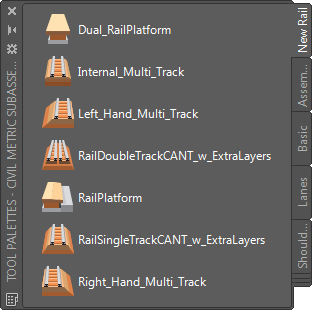

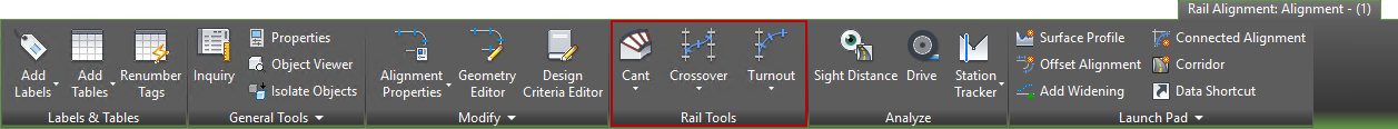

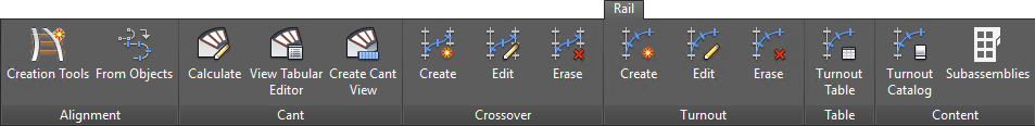

On the Rail ribbon tab, click Subassemblies
to open the New Rail tool palette.
For more information, see New Rail Subassemblies.

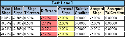

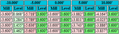

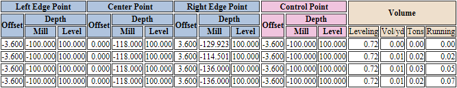

| Stylesheet | Features | Example |
| Report Rehab-All – with colour.xsl |
| AL DOT Cross Slope.xsl |
| Mill and Level – with colour.xsl |
| AL DOT Mill and Level.xsl |
For information about how to select these stylesheets, see To Generate Rehab Corridor Reports.

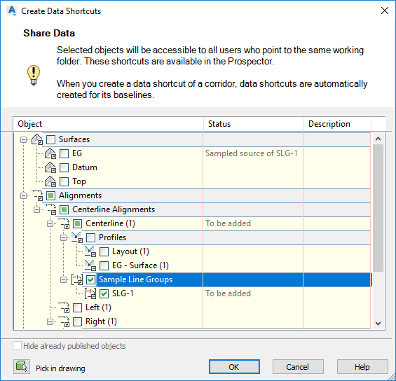

When you create a data shortcut for a sample line group, a data shortcut to the parent alignment is also created. For more information, see To Work With Data Shortcuts.
When you create the data references, you can specify which sample lines in the sample line group to reference and which data sources to sample. For more information, see To Create Sample Line Group References.
