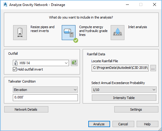

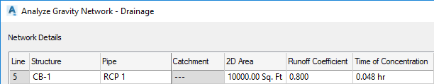

The Autodesk® Civil 3D® 2019.3 Update contains the following new features and enhancements.
The updated command uses a modeless dialog box so you can leave it open while you do other work.
You can use this command to perform the following analysis types:
For more information, see About Analyzing and Sizing a Gravity Pipe Network.

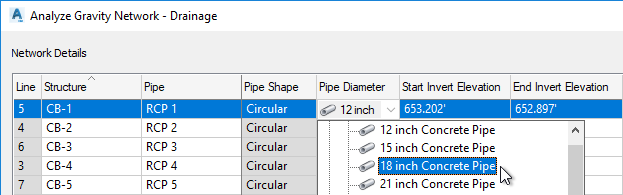

The pipes in the current parts list are now shown and can be selected manually on the Network Details page from a drop-down list.

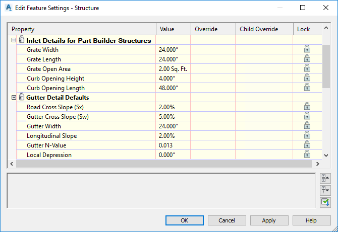

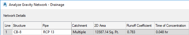

By setting up and applying the mapping for these parts, the parameter values will be available within the Analyse Gravity Network command by default.
For more information, see To Map Drainage Structure Parameters for Gravity Network Analysis.
For more information, see About Analysing and Size a Gravity Pipe Network and Edit Feature Settings – Structure Dialog Box.

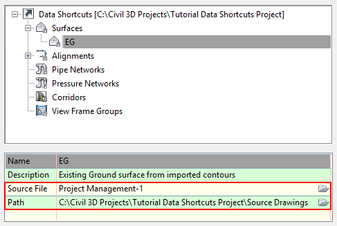

After selecting the alternate Source File or Path, a dialog box is displayed which you can use to update the shortcuts. Drawing objects that reference the original path will be updated to reference the alternate path.
