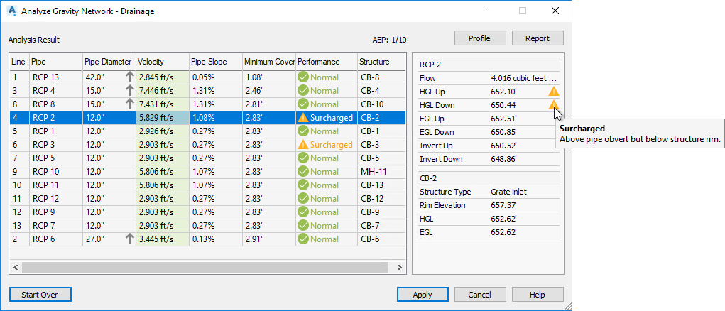

Results Page (Analyse Gravity Network Dialog Box)
Use this page of the dialogue box to review the analysis results and to apply them to the pipe network.
When you click the Analyse button in the Analyse Gravity Network dialog box, the Results page is displayed.
Visual cues and tooltips are displayed to indicate the analysis results.
When you select a row in the results table, the right panel displays detailed information about the pipe and structure in the selected line and the corresponding line in the drawing is highlighted.
You can access commands to zoom to, pan to and select a line in the drawing by right-clicking the row and selecting a command on the context menu. Selecting the line selects both the pipe and the structure.

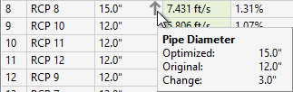

Pipe Diameter
Displays the pipe diameter.
If the Resize Pipes and Reset Inverts analysis type was selected on the General page and a pipe diameter was resized, this column will contain either an up arrow or a down arrow. When you place your cursor over the arrow, a tooltip is displayed that explains how the pipe was resized.

Performance
Displays either Normal, Surcharged, or Flooded. The analysis checks the EGL and HGL of the start and end of the pipe and of the structure and the most severe status that is determined for the line is reported.
  • Normal: The HGL is below the pipe obvert level.
  • Surcharged: The HGL is above the pipe obvert level but below the structure cover.
  • Flooded: The HGL and/or EGL are above the structure cover.
This column is displayed if Compute Energy and Hydraulic Gradient Lines is selected on the General page.
Details about the issues are displayed on the right side of the dialogue box.

Line Details
When you select a row in the results table, the right panel displays detailed information about the pipe and structure in the selected line. Different details are shown depending on the analysis types that are selected on the General page.
Pipe Details
Flow
Displays the total amount of flow that is passing through the pipe.
This row is displayed if Resize Pipes and Reset Inverts is selected on the General page.
HGL Up
Displays the HGL of the upstream end of the pipe.
This row is displayed if Compute Energy and Hydraulic Gradient Lines is selected on the General page.
HGL Down
Displays the HGL of the downstream end of the pipe.
EGL Up
Displays the EGL of the upstream end of the pipe.
EGL Down
Displays the EGL of the downstream end of the pipe.
Invert Up
Displays the invert of the upstream end of the pipe.
This row is displayed if Resize Pipes and Reset Inverts or Compute Energy and Hydraulic Gradient Lines is selected on the General page.
Invert Down
Displays the invert of the downstream end of the pipe.
Structure Details
Structure Type
Displays the structure type.
This row is displayed if Compute Energy and Hydraulic Gradient Lines or Inlet Analysis is selected on the General page.
cover Level
Displays the cover level of the structure.
HGL
Displays the HGL of the structure.
EGL
Displays the EGL of the structure.
Flow
Displays the total amount of flow that is either captured by, or bypasses, an inlet structure.
This row is displayed if the structure is an inlet and Inlet Analysis is selected on the General page.
Captured Flow
Displays the amount of flow that is captured by an inlet structure.
Bypass Flow
Displays the amount of flow that bypasses an inlet structure.
