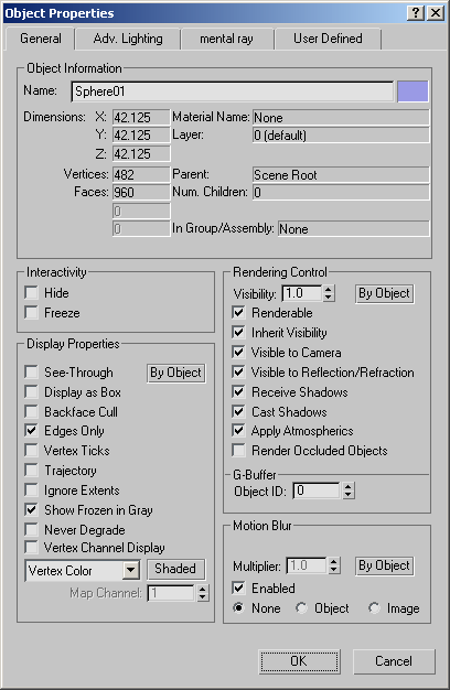

<node>.xray Boolean default: false
Get or set whether the node is displayed in See Through mode in shaded viewports.
<node>.boxMode Boolean default: false
Get or set whether the node is displayed in box mode in the viewports.
<node>.allEdges Boolean default: false
Get or set whether all the node's edges are displayed in the viewports.
<node>.vertexTicks Boolean default: false
Get or set whether all the node's vertices will be displayed as ticks in the viewports.
<node>.backFaceCull Boolean default: false
Get or set whether the node's back faces are culled (not displayed) in the viewports.
<node>.showTrajectory Boolean default: false
Get or set whether the node's trajectory is displayed in the viewports.
<node>.ignoreExtents Boolean default: false
Get or set whether the extents of the node is ignored when performing a zoom extents.

<node>.wireColor Color default: random color
Get or set the node's wireframe color

<node>.renderable Boolean default: true
Get or set whether the node is renderable.
<node>.inheritVisibility Boolean default: true
Get or set whether the node inherits the visibility of its parent object (if any). This property parallels the Inherit Visibility property in an object's right-click Object Properties dialog.
<node>.primaryVisibility: boolean : Read|Write
Gets/Sets the node’s Visible to Camera option.
Exposed by the INode Interface.
<node>.secondaryVisibility: boolean : Read|Write
Gets/Sets the node’s Visible to Reflection/Refraction option.
<node>.receiveShadows Boolean default: true
Get or set whether the node receives shadows when rendered. This property parallels the Receive Shadows property in an object's right-click Object Properties dialog.
<node>.castShadows Boolean default: true
Get or set whether the node casts shadows when rendered. This property parallels the Cast Shadows property in an object's right-click Object Properties dialog.
<node>.applyAtmospherics: boolean : Read|Write
Gets/Setswhether the node will be affected by atmospheric effects.
<node>.renderOccluded Boolean default: false
Get or set whether to Render Occluded Objects behind the node. This property parallels the Render Occluded Objects property in an object's right-click Object Properties dialog.
<node>.gbufferChannel Integer default: 0
Get or set the node's g-buffer Object ID channel value. Valid object ID values in 3ds Max range from 0 to 65535. This property parallels the G-Buffer Object Channel property in an object's right-click Object Properties dialog.
<node>.imageMotionBlurMultiplier Float default: 1.0 -- animatable
Get or set the node's image motion blur multiplier value. The controller for this property is stored in the 6 th subAnim of the node. You can access this controller as:
<node>[6].controller-- the imageMotionBlurMultiplier controller
You can also get and set a node's imageMotionBlurMultiplier controller using the getImageBlurMultController() and setImageBlurMultController() methods.
<node>.motionBlurOn Boolean default: true
Get or set whether motion blur is enabled for the object. This property parallels the Motion Blur Enabled property in an object's right-click Object Properties dialog.
<node>.motionBlurOnController Controller default: undefined
Get or set the motion blur on/off controller used for the node.
<node>.motionBlur Name default: #none
Get or set the type of motion blur to be used for the node. Valid parameter values are: #none , #object , and #image . For backward compatibility, this property can also be set to false for none or true for object motion blur. This property parallels the Motion Blur type specified in an object's right-click Object Properties dialog.

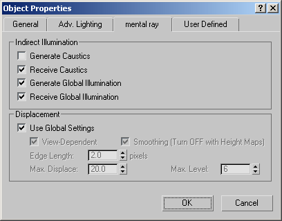

<node>.generatecaustics Boolean default: false
Get or set whether the node generates caustics. Caustics are not supported by the 3ds Max scanline renderer.
<node>.rcvcaustics Boolean default: true
Get or set whether the node receives caustics. Caustics are not supported by the 3ds Max scanline renderer.
<node>.generateGlobalIllum Boolean default: false
Get or set whether the node generates global illumination. Global illumination is not supported by the 3ds Max scanline renderer.
<node>.rcvGlobalIllum Boolean default: true
Get or set whether the node receives global illumination. Global illumination is not supported by the 3ds Max scanline renderer.
