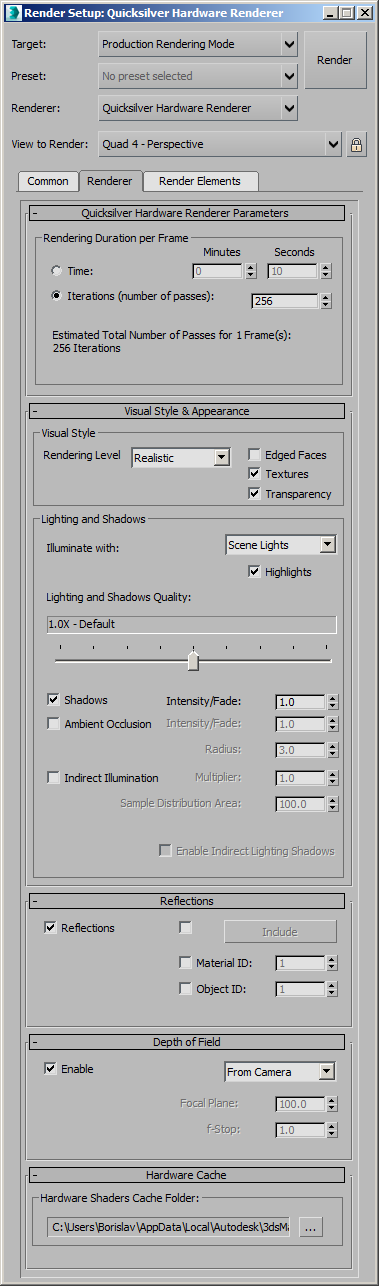

Quicksilver_Hardware_Renderer interfaces:
Interface: IQuicksilverRenderer
Properties:
<Quicksilver_Hardware_Renderer>.RenderingMode Name default: #iterations -- enum
Get/set the state of the Rendering Mode radio buttons.
Possible values are:
#time - the Per-Frame Duration in seconds will be controlled by the .RenderingTime value.
#iterations (default) - the number of iterations specified by the .RenderingIterations property will be performed, resulting in variable Per-Frame Duration depending on the complexity of each frame.
Available in 3ds Max 2012 and higher.
<Quicksilver_Hardware_Renderer>.RenderingTime Integer default: 10 -- integer
Get/set the rendering duration in seconds.
This value will be used when the .RenderingMode is set to #time .
Valid range is from 1 to 3540, default value is 10.
Note that the User Interface exposes this value as two spinners - Minutes and Seconds.
The Seconds spinner cannot be set to 0 to avoid the entering of 0 Minutes 0 Seconds.
Thus setting the .RenderingTime value to 120 via MAXScript will result in 2 Minutes and 1 Second and not 2 Minutes 0 Seconds, and the internal value will be stored as121 seconds!
<Quicksilver_Hardware_Renderer>.RenderingIterations Integer default: 256 -- integer
Get/set the number of iterations to perform when the .RenderingMode property is set to #iterations
This is the number of iterative refinement steps performed by the Nitrous Graphics system introduced in 3ds Max 2012.
Min. value is 1, Max. value is 4096, Default is 256.
Similar properties and methods are exposed by the NitrousGraphicsManager Interface for controlling the viewport Visual Style.
Properties:
<Quicksilver_Hardware_Renderer>.VisualStyle Name default: #Realistic -- enum
VisualStyle enums: { #Realistic | #Shaded | #ConsistentColors | #HiddenLine | #Wireframe | #Clay | #BoundingBox | #Ink | #ColorInk | #Acrylic | #Tech | #Graphite | #ColorPencil | #Pastel }
Get/set the rendering visual style.
<Quicksilver_Hardware_Renderer>.EdgedFaces BooleanClass default: false -- bool
Get/set the state of the Edged Faces checkbox.
<Quicksilver_Hardware_Renderer>.TextureEnabled BooleanClass default: true -- bool
Get/set the state of the "Textures" checkbox.
When set to true (default), textures will be rendered.
When set to false, textures will be ignored.
<Quicksilver_Hardware_Renderer>.TransparencyEnabled BooleanClass default: true -- bool
Enable/Disable the calculation of transparency.
Default value is false.
Methods:
<string by value><Quicksilver_Hardware_Renderer>.GetNPRParameterInfo()
Returns information about the parameters exposed by the current visual style.
<integer><Quicksilver_Hardware_Renderer>.GetNPRParameterCount()
Returns the number of parameters exposed by the current visual style.
<string by value><Quicksilver_Hardware_Renderer>.GetNPRParameterName <integer>index
Returns the name of the indexed parameter. The index is zero-based.
<enum><Quicksilver_Hardware_Renderer>.GetNPRParameterType <integer>index
GetNPRParameterType enums: { #Unknown | #Bool | #Int | #Float | #Float4 | #String }
Returns the type of the indexed parameter. The index is zero-based.
<bool><Quicksilver_Hardware_Renderer>.GetNPRBool <string>name
Returns the value of the named boolean parameter.
<void><Quicksilver_Hardware_Renderer>.SetNPRBool <string>name <boolean>value
Sets the value of the named boolean parameter to the boolean value passed as second argument.
<string by value><Quicksilver_Hardware_Renderer>.GetNPRString <string>name
Returns the value of the named string parameter.
<void><Quicksilver_Hardware_Renderer>.SetNPRString <string>name <string>value
Sets the value of the named string parameter to the string value passed as second argument.
<integer><Quicksilver_Hardware_Renderer>.GetNPRInt <string>name
Returns the value of the named integer parameter.
<void><Quicksilver_Hardware_Renderer>.SetNPRInt <string>name <integer>value
Sets the value of the named integer parameter to the Integer value passed as second argument.
<integer><Quicksilver_Hardware_Renderer>.GetNPRMinInt <string>name
Returns the minimum range value of the named integer parameter.
<integer><Quicksilver_Hardware_Renderer>.GetNPRMaxInt <string>name
Returns the maximum range value of the named integer parameter.
<float><Quicksilver_Hardware_Renderer>.GetNPRFloat <string>name
Returns the value of the named float parameter.
<void><Quicksilver_Hardware_Renderer>.SetNPRFloat <string>name <float>value
Sets the value of the named float parameter to the Float value passed as second argument.
<float><Quicksilver_Hardware_Renderer>.GetNPRMinFloat <string>name
Returns the minimum range value of the named float parameter.
<float><Quicksilver_Hardware_Renderer>.GetNPRMaxFloat <string>name
Returns the maximum range value of the named float parameter.
<point4><Quicksilver_Hardware_Renderer>.GetNPRFloat4 <string>name
Returns the Point4 value of the named float4 parameter.
<void><Quicksilver_Hardware_Renderer>.SetNPRFloat4 <string>name <point4>value
Sets the value of the named float4 parameter to the Point4 value passed as second argument.
<point4><Quicksilver_Hardware_Renderer>.GetNPRMinFloat4 <string>name
Returns the minimum range value of the named float4 parameter.
<point4><Quicksilver_Hardware_Renderer>.GetNPRMaxFloat4 <string>name
Returns the maximum range value of the named float4 parameter.
<void><Quicksilver_Hardware_Renderer>.ShowNPRParameters()
For future use.
Properties:
<Quicksilver_Hardware_Renderer>.UseDefaultLights BooleanClass default: false -- bool
Get/set whether to use the Default Lights (True) or the Scene lights (False).
<Quicksilver_Hardware_Renderer>.Highlights BooleanClass default: true -- bool
Get/set whether to render with Highlights (True, Default) or without Highlights (False).
Available in 3ds Max 2013 and higher.
<Quicksilver_Hardware_Renderer>.IndirectIlluminationEnabled BooleanClass default: false -- bool
Enable/Disable Indirect Illumination calculations.
Default value is False.
<Quicksilver_Hardware_Renderer>.IndirectIlluminationMultiplier Float default: 1.0 -- float
Get/set the Indirect Illumination Multiplier value.
Valid values are between 0.0 and 3.0
Default value is 1.0.
<Quicksilver_Hardware_Renderer>.IndirectIlluminationSampleArea Float default: 100.0 -- float
Get/set the Indirect Illumination Sample area value.
<Quicksilver_Hardware_Renderer>.IndirectIlluminationLODEnabled BooleanClass default: false -- bool
Get/set the state of the Indirect Illumination Level Of Detail option.
<Quicksilver_Hardware_Renderer>.IndirectIlluminationShadowEnabled BooleanClass default: false -- bool
Enable/Disable Indirect Illumination Shadows.
<Quicksilver_Hardware_Renderer>.IndirectIlluminationShadowRange Integer default: 8 -- integer
Get/set the Indirect Illumination Shadow Range value.
Valid values are between 1 and 32.
Default value is 8.
<Quicksilver_Hardware_Renderer>.IndirectIlluminationShadowSize Integer default: 256 -- integer
Get/set the Indirect Illumination Shadow Size value.
Valid values are between 32 and 2048.
Default value is 256.
<Quicksilver_Hardware_Renderer>.IndirectIlluminationRSMSize Integer default: 256 -- integer
Get/set the Indirect Illumination RSM Size value.
Properties:
<Quicksilver_Hardware_Renderer>.UseShadows BooleanClass default: true -- bool
Get/set whether to use shadows.
Default value is true.
<Quicksilver_Hardware_Renderer>.SoftShadowMultiplier Float default: 1.0 -- float
Get/set the Soft Shadows Multiplier value.
Valid values are:
0.0 - Point Lights / Hard Shadows
0.125 - Very Low
0.25 - Low
0.5 - Medium
1.0 - Default
2.0 - High Quality
4.0 - High Quality
8.0 - High Quality
16.0 - Very High Quality
Any other values will be ignored.
<Quicksilver_Hardware_Renderer>.ShadowIntensity Float default: 1.0 -- float
Get/set the Shadow Intensity/Fade value.
Valid range is 0.0 to 1.0.
<Quicksilver_Hardware_Renderer>.AmbientOcclusionEnabled BooleanClass default: false -- bool
Enable/Disable Ambient Occlusion.
<Quicksilver_Hardware_Renderer>.AmbientOcclusionIntensity Float default: 1.0 -- float
Get/set the Ambient Occlusion Intensity/Fade value.
Valid range is 0.0 to 2.0.
<Quicksilver_Hardware_Renderer>.AmbientOcclusionRadius Float default: 3.0 -- float
Get/set the Ambient Occlusion Radius value.
Valid range is 0.0 to 200.0.
Default value is 3.0.
Properties:
<Quicksilver_Hardware_Renderer>.ReflectionsEnabled BooleanClass default: true -- bool
Enable/Disable the calculation of reflections.
Properties:
<Quicksilver_Hardware_Renderer>.DepthOfFieldEnabled BooleanClass default: true -- bool
Enable/Disable Depth Of Field calculations.
<Quicksilver_Hardware_Renderer>.DepthOfFieldMode Name default: #camera -- enum
Get/set the Depth Of Field mode.
#Camera - (default) -uses the Camera's Depth Of Field settings.
