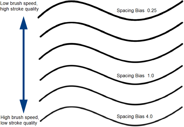

Brush optimization
  • Only set a lower spacing bias (<1.0) and turn on Rotate to stroke when they are required for a specific brush effect. If non-optimal brush parameters are used, you may see performance degradation.
    • The brush parameter Rotate to stroke should only be used with texture brushes, shape brushes, or elliptical brush stamps because this requires extensive computation. With all other brush strokes, the rotation of a circular brush stamp is visually meaningless.
    • Reducing brush stamp spacing bias can dramatically improve brush stroke quality, but at a certain point reducing the spacing bias does not improve the stroke quality — it only reduces the performance. Increasing brush stamp spacing bias dramatically improves brush speed, but the visual appearance may not be a smooth stroke if the individual brush stamps are spaced too widely.
      Tip:
      When sketching, find the balance between quality and speed. While a small brush stamp bias may improve the smoothness, it results in slower brush performance; using a large stamp bias provides additional speed, but may not provide the quality.

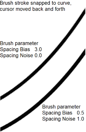

Stroke quality using curve snap
  • When brushing and using snap-to-curve functionality, the brush stamp is placed in the same relative position on the curve each time you move the cursor along the same region of the curve. This can cause the finished stroke to look rough or poorly aliased. If this is the case, add a little spacing noise to the brush stroke to ensure uneven stamp spacing and decrease the stamp spacing.

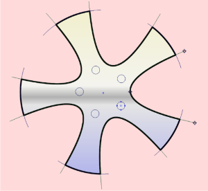

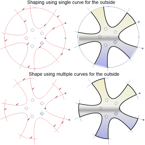

Shapes and multiple curve regions
  • If you need to use two regions of the same curve to define a shape, click on each section while in the Paint > Shape tool, or choose Object Edit > Attach > Detach or Curve Edit > Curve Section to break the curve into separate segments.
    Note:
    In the top image below, clicking once on the circle would work, but this might not always be the case for other configurations.

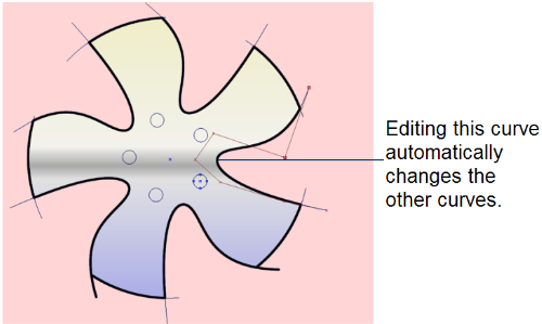

Re-use curves
  • Each curve can be used any number of times to form different shapes. For example, the wheel example below shows how the curves have been used to define an image shape with a ramp fill and a mask shape.

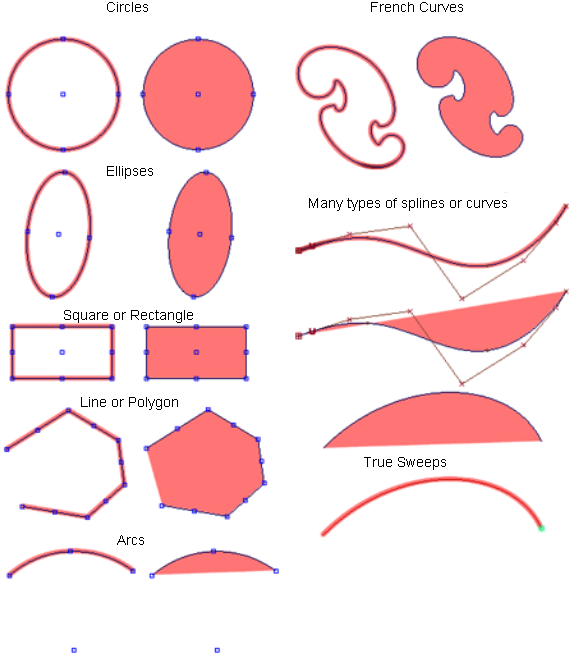

Fast shape and mask creation tools
  • Use Auto-shapes. To quickly and easily create a simple image shape, mask shape, or invisibility mask shape, turn on Auto-Shapes in the paint panel. This will allow any Alias curve tool to automatically create shapes objects. Below is a small sample of the types of curves supported by Alias auto-shape functionality.

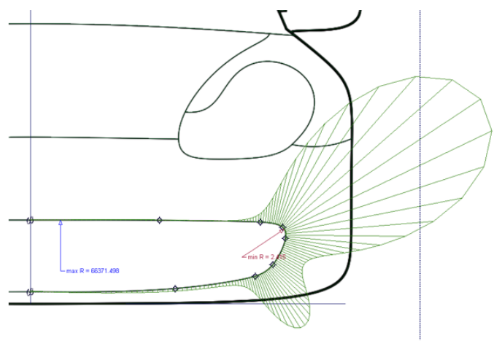

Curve evaluation
  • Use the Alias curve curvature tools to improve the line quality of your design.

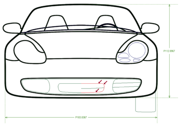

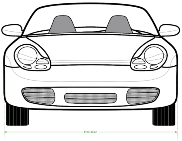

  • By using the curve tools and dimension tools, you can create elevation sketches or tape drawing at real world scale. Import 3D package constraints from the engineers and sketch over these constraints: don’t start sketching orthographic views without a concept of real world size or scale.

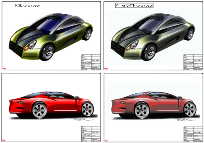

Printer color space versus RGB color space
  • Learn what colors work well with your printer. Use the AliasPrint Preview window to get a better understanding of RGB and CMYK color spaces – they are different. Below is a simple example showing the difference between RGB and CMYK color spaces. Notice how switching from RGB to CMYK can make a dramatic sketch look flat and boring. Every printer in the world has a unique color space in how it deals with hue, saturation and value – learn what colors and saturations work well with your printer. Don’t spend time creating a fabulous sketch on the screen that prints out or electronically projects poorly.

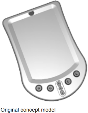

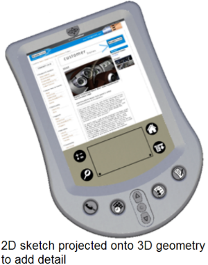

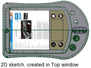

Add design detail to 3D models quickly
  • Use the sketch projection workflow to add detail to early 3D concept models.
