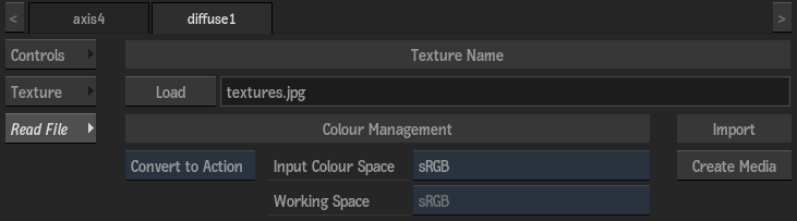

You create maps in Action (such as Diffuse and Reflection maps) based on media from the Media list. In some cases, such as with Substance Textures, the media is automatically applied to map nodes. To specify different media as the texture source, select the media in the Media menu, then click Apply. If the media you want to use resides elsewhere on your filesystem, you can use the Read File tab of the map menu to load the texture, and then decide if you want the texture to be managed by Action, or not.
