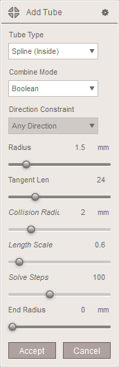

The property panel for the Add Tube tool is shown below. The different Tube Type options result in significantly different behavior, which is described below.
The Combine Mode option is used to determine what we do with the tube geometry when you Accept the tool. Direction Constraint controls the tube orientation in certain modes, as described below.
The Radius is used in all modes and defines the diameter of the tube. If you would like the radius to vary over the length, you can also set the End Radius at the bottom of the panel. This value is ignored if it is zero.
The Tangent Len is used in the Spline modes, and defines the length of the tangent vectors, as described below.
Collision Radius, Length Scale, and Solve Steps are used in the auto-routing algorithm.

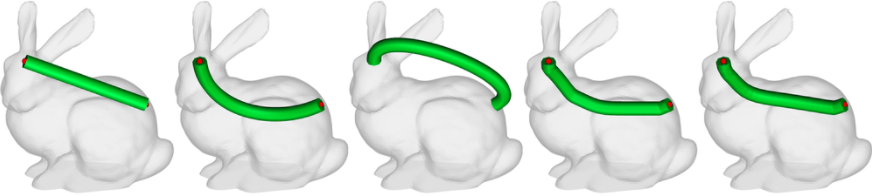

There are three main type categories: Line, Spline, and AutoRoute. In Line mode, the tube is a cylinder (or cone) which is oriented with the line between the two handles. The only difference between Line (Outside) and Line (Inside) modes is that if you are using the Boolean combine mode, then in Outside mode the tube is Unioned while when Inside it is Subtracted.
The Spline (Outside) and Spline (Inside) modes also allow you to specify Union vs Subtract. However in addition they determine whether the spline goes "into" the surface or comes "out of" it. Given the two endpoints and their normals, we define a 3D Bezier curve by setting the Bezier tangents to the normal vectors, with Tangent Len defining the lengths of the tangents. See the second and third images below for an example of Inside and Outside modes for the same two endpoints.

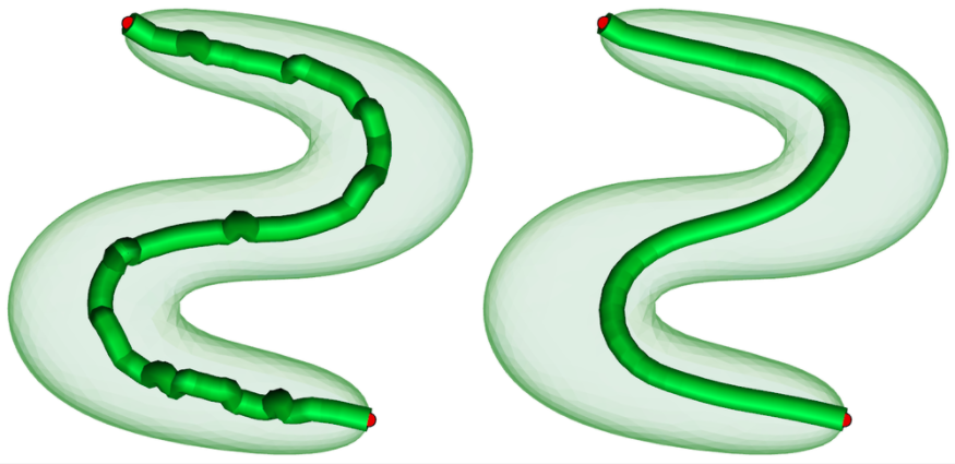

The image below shows an example of AutoRoute Miminal on the left and AutoRoute Smooth on the right. The Minimal mode is quite simple, it is based on a simple path-finding through a voxelized version of the model, combined with some smoothing. The Collision Radius parameter defines how close the tube is allowed to get to the model surface (except at the endpoints). In the example below we have set this threshold to too high a value, which produces kinks in the minimal routing.
In AutoRoute Smooth, we begin with the Minimal routing, but then use a physics simulation to attempt to find a minimal-curvature version of the path. The path is essentially treated as a thin rubber wire, and we allow it to relax to its smoothest state, while still enforcing our Collision Radius.
The Length Scale parameter allows you to further relax or tighten the result, essentially by changing the length of this rubber wire. If you make it much longer than necessary, it will even coil up to be able to fit. The Solve Steps parameter determines how many iterations of the physics simulation are run. More steps takes longer but can get to smoother results. However, we must emphasize that this simulation results in some level of randomness in the result. So, when you make small changes to the endpoints or the parameters, you may see quite different interior curves if there is freedom in the solution.
