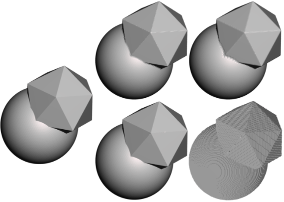

The Solid Type drop-down controls the basic behaviour of the Make Solid tool. There are four modes available, described below. The image below shows an example with an original object (left) that has two overlapping shells.
The Fast mode (top left) is the default. In this mode we mesh the voxel approximation, and then re-project the vertices back onto the input surface. This is quite fast and works well in easy cases, but the re-projection can introduce artifacts in complex areas.
Accurate mode (top right) takes the voxel approximation and computes a signed distance field which approximates the input object. We then mesh this distance field. Computing this distance field is significantly more expensive than Fast mode, and in some cases the result will not be as good as Fast mode (like in our example below). However, the signed distance field has other uses, as we will see.
Block mode (bottom right) simply meshes the voxel cubes, giving a blocky object. Note that sometimes non-manifold junctions will exist in this mesh.
Sharp Edge Preserve mode (bottom left) is based on Fast mode, but after the re-projection we try to recover sharp edges in the input. The way this is done is similar to the multi-step workflow described in the Edit > Attract to Target tool. This mode can be extremely slow, and still does not give perfect results, however you can quickly resolve small flaws using Attract to Target.

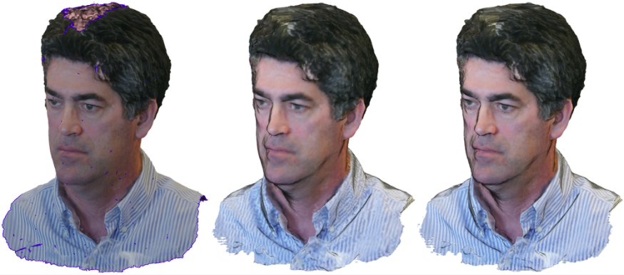

After we have resampled your input mesh, we can also resample the colors on those meshes. Currently we only support Vertex colors on the solid mesh. So, if your input object has Vertex colors, we evaluate the interpolated vertex color at each vertex on the solid mesh. This is Vertex-to-Vertex mode. If your input object has UV-mapped textures, then Material-to-Vertex mode will result in the color map being "baked" to the Vertex colors in the solid mesh. An example is shown below. The leftmost image shows the original textured mesh (with many holes). Middle is the default Make Solid result. You can see many artifacts on the shirt because the vertex density is quite low compared to the texture resolution. In the rightmost image we have increased the solid mesh density to get a crisper approximation. Note that the holes have also been filled with colors.
No Colors mode disables color transfer. The Automatic mode is the default. In this mode, the Material-to-Vertex mode is used if the input object has UV-mapped textures, otherwise vertex colors are transferred.

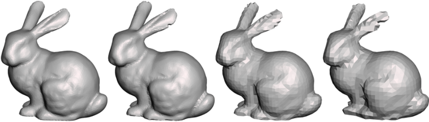

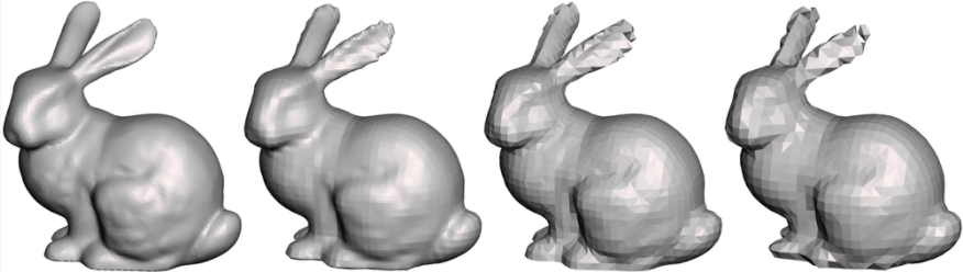

We explained above that Make Solid approximates your object with voxels. This approximation actually happens twice. First we voxelize the shape using Solid Accuracy as the sampling rate. Then we use a second set of voxels to create a mesh of the first voxel approximation. Mesh Density is the sampling rate of this second voxelization. These sampling rates can be the same, but they do not have to be.
The example below shows Fast mode with solid/mesh rates of 128/128, 32/128, 128/32, and 32/32. The effect of reducing the Mesh Density is clear - fewer triangles. Reducing Solid Accuracy is a bit less obvious in this mode because of the reprojection step. However even in the second image we can see that some details are lost due to the low-resolution underlying solid.
The next image shows the same solid/mesh rates as above, in Accurate mode. Here, because we do not reproject the mesh onto the input surface, the effect of the lower Solid Accuracy is more obvious in the second image. A high-resolution mesh of a low-resolution solid makes it clear that the underlying surface is essentially a smoothed-blocky version of the input object. The smoothing is done by a linear filter.

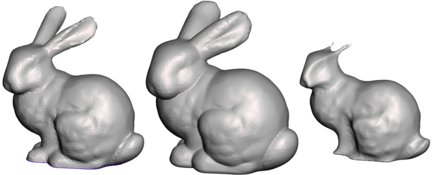

A significant benefit of the Accurate Solid Type is that we can compute offset surfaces of the signed distance field that we have computed. This is done via the Offset Distance slider. Positive distances result in outer shells, and negative distances create inner shells. We use this capability in the Hollow Tool. The accuracy of the offset surface is on the order of one cell-width. The offset is still a solid with no self-intersections, which is one advantage over our mesh-based Edit > Offset tool. Note, however, that if the original Make Solid has lost thin features, the offset surface will usually have the same artifacts. Also, we only compute the distance field out as far as necessary, so large offsets will take longer to find than small ones.

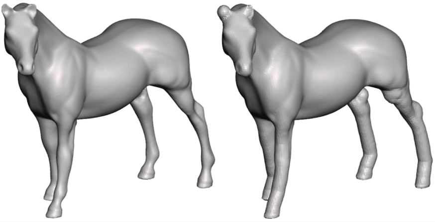

Another capability of the Accurate Solid Type is that we can attempt to selectively thicken thin regions of the input, using the Min Thickness setting. The example below shows a horse model which is quite small (about 25mm tall). At this size the legs are very thin. The right image is the Solid version with a min thickness of 1.5mm. Note how the thin legs have been locally thickened, but the body is unmodified.
Currently the way we achieve this thickening is to add in small spheres with a diameter set to the minimum thickness. This can unfortunately lead to artifacts. The image below shows the same horse but with Min Thickness set to 2.0mm. Notice how the legs have gotten quite bumpy and rounded. This is, of course, due to the spheres we have added. Our detection algorithm can also go wrong, like it has on the horse's right ear above. This capability is somewhat of a work in progress, but you may find it helpful in some cases.

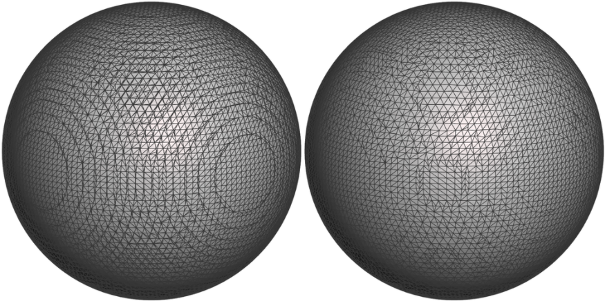

The strategy we use to mesh the solid approximation we create initially produces meshes with many small and thin triangles. The Cull Edges Threshold slider controls a post-processing pass that discards these tiny edges. We throw any edges away that are a fraction of the voxel edge length. The slider is specifying this fraction, with 100 being 25% of the edge length. Note that this cleanup can introduce artifacts, particularly on very smooth or thin areas. You can get better results by setting this value to 0 and manually remeshing using the Edit > Remesh tool, however it will be much slower.

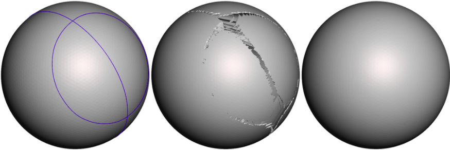

Make Solid works best with input objects that are a set of closed shells. However, you can also run it with meshes that contain holes. In this case our default behaviour is to automatically fill the holes before we try to create the solid, using the Minimal mode of the Edit > Erase & Fill tool. However, in the special case where your input object is a set of adjacent open patches of mesh, then each patch boundary will be treated as a hole and filled. This will likely produce terrible results, as shown in the example below. In this case you can un-check Close Open Boundaries to skip the hole-filling step.

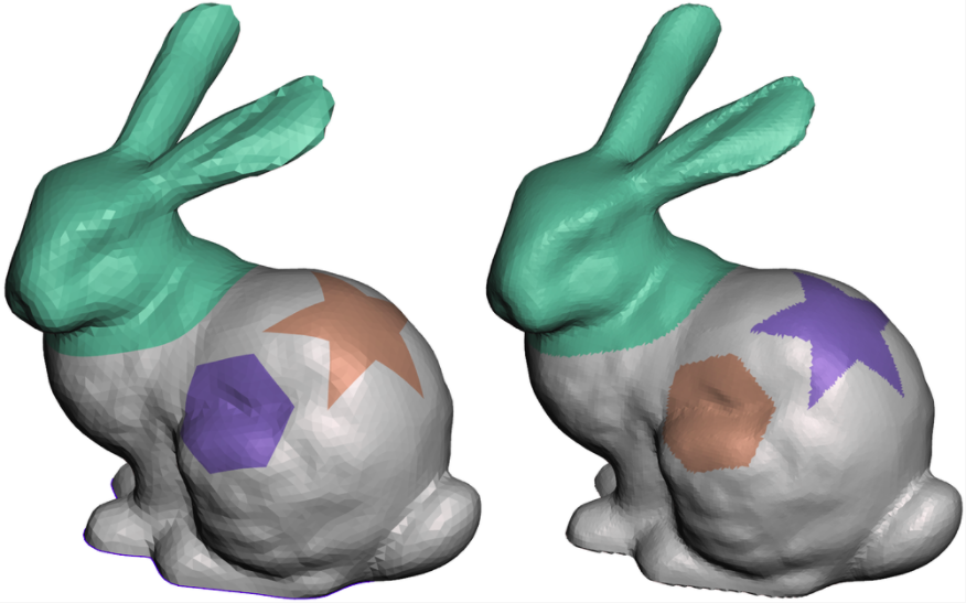

When enabled, the Transfer Groups option attempts to map the face groups of your input objects to the output solid mesh. This is done much like the Color transfer above. For each triangle in the solid mesh, we find the nearest triangle on the input mesh, and use that triangle's face group. However, because the triangles have different shapes, this will always lead to a jaggy boundary on the solid mesh, and in some cases, disconnected triangles from the same face group. You can try to clean this up using Select > Modify > Smooth Boundary.
