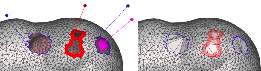

The image below shows an example of each problem type. Blue highlights represent holes in the mesh. The auto-repair attempts to fill holes using the strategies of the Edit > Erase & Fill tool.
Red highlights indicate non-manifold regions. Non-manifold elements are "bowtie" vertices or edges with more than two connected triangles. Note that we merge overlapping artifacts into the "worst-case" option, so in the example below, the bowtie vertex overlaps a hole, and hence the entire hole is marked as non-manifold. To repair a non-manifold region, we first delete the triangles highlighted in red, and then attempt to fill the resulting hole.
Magenta highlights indicate small-component areas. These regions are simply deleted. We identify small components as having a small surface area relative to the total model surface area. The default threshold is 1%.

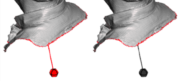

We mentioned above that Holes and Non-manifold regions are repaired by filling holes (either existing or created by deleting triangles). If this fails for some reason, our strategy is to erode the hole by one ring of triangles and try again. This is repeated several times for each problem area. However, these repairs strategies can still fail. If you left-click a sphere and the repair fails, it will turn grey, as shown in the image below. In this case the only fallback is to right-click to select this area, and try to repair it manually.
