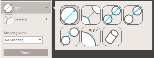

Type
There are a variety of quite different measurement types available in the Type flyout shown below. There are two main categories. In the top row, the measurement is taken from a single point, the measure point, in a fixed direction, to various distances. The default direction is the surface normal, unless the Direction flyout is modified.
In the top row, from left to right we have:
The second row contains three other types, from left to right:

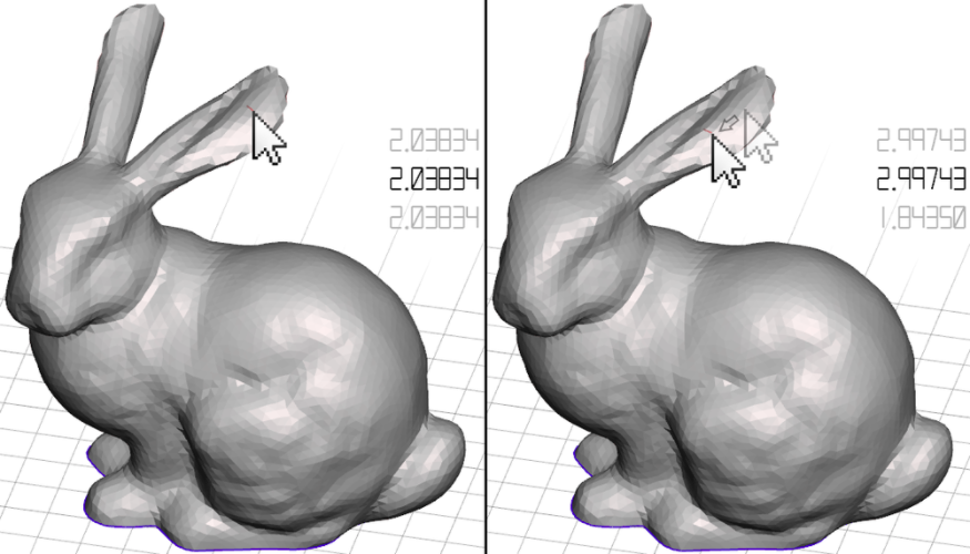

The image below shows two sample usages of the basic top-row measure types. To set the measure point you left-click on the surface of the model. As soon as you press down the mouse button, the measurement value will appear on the right edge of the 3D view, as shown in the image below left. The measurement distance is shown in 3D, as a red line, however in this image it is quite small.
If you continue to hold the left button and move the mouse, the measurements will be accumulated, as shown above-right. This is why three numbers are shown on the right. The middle black number shows the measurement at the cursor point. The upper grey number is the maximum measured value along the mouse path, and the lower grey number is the minimum measured value. The purpose of these is so that you can scrub over an area to find the min and max values, which may be useful if you are trying to verify a tolerance or determine a maximum thickness, for example.

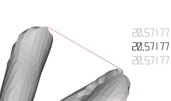

Point-to-Point
This measure type is similar to the single-point modes, but you explicitly define both the start and end of the measurement, instead of using a raycast. The second point is positioned by either shift-left-click or right-click if available. Like the single-point modes, the values to the right show the minimum and maximum distances over a single click-drag movement.

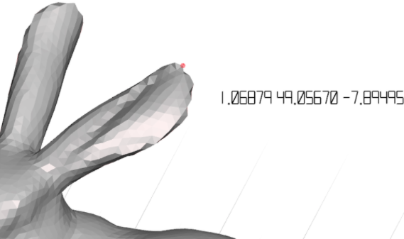

Point Coordinates
This measure type allows you to query the 3D position of a point on the model surface. Instead of a single measurement value, the three X/Y/Z coordinates are shown to the right. The measurement point is shown as a small red dot.

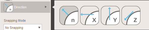

Direction
The Direction flyout is used to change the ray direction used in the single-point modes described above. The default is the normal direction. You can instead use the canonical world-space X, Y, and Z axis directions, by selecting the appropriate button in the flyout. These can be useful in different situations, for example the Y direction can tell you the height of points relative to the ground plane, and the X and Z modes can be used to measure in-layer thicknesses for 3D printing.
