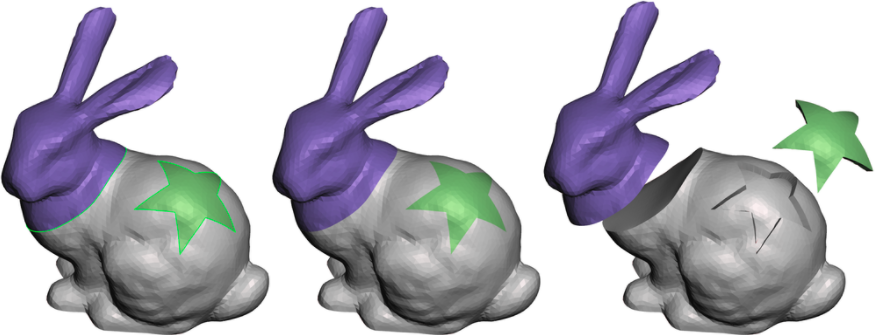

The Split Complex tool, found under the Edit tab, is used to decompose a selected Complex object into separate solids. In the images below, the leftmost image shows the original Complex. The next image shows what you would see if you ran Split Complex.
Although it looks like the green edges have simply disappeared, in fact the three sub-regions have been separated into new Mesh scene objects. They will all be highlighted because the default is to select them all. However in the Object browser (shown below) you will see that three new "split" objects have been added. The rightmost image shows these separate watertight solids shifted apart.
