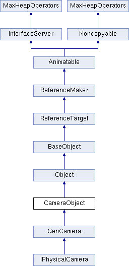

CameraObject Class Reference
#include <object.h>
Class Description
This is a base class from which camera plug-ins may be derived.
Methods of this class are used to get and set properties of the camera. All methods of this class are virtual. To ensure that the camera has a valid targDist during network rendering, be sure to call UpdateTargDistance( TimeValue t, INode* inode ); This call should be made PRIOR to cameraObj->EvalWorldState().
See also
Class Object
+ Inheritance diagram for CameraObject:
