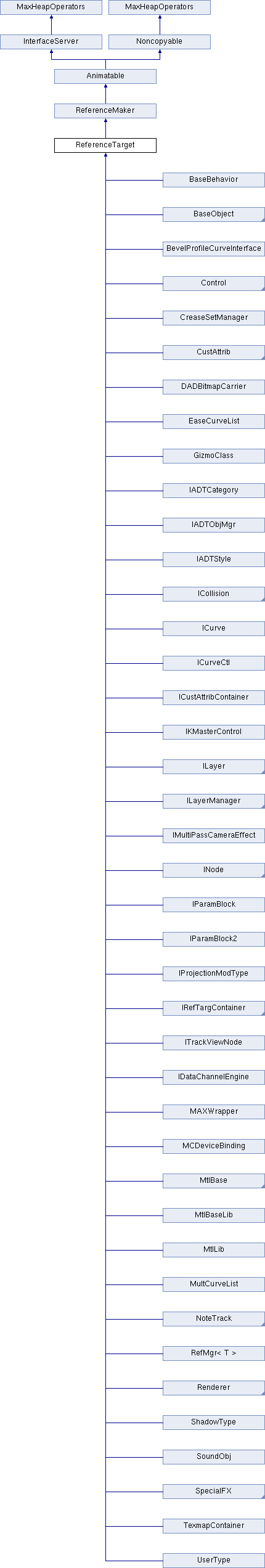

+ Inheritance diagram for ReferenceTarget:
