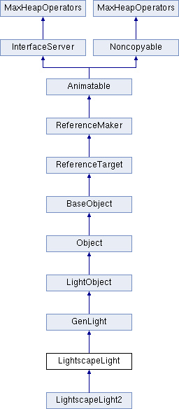

LightscapeLight is the base class for all Photometric lights. You can safely cast an Animatble* to LightscapeLight* if IsSubClass(LIGHTSCAPE_LIGHT_CLASS) returns true.
Inheritance diagram for LightscapeLight:Classes | |
