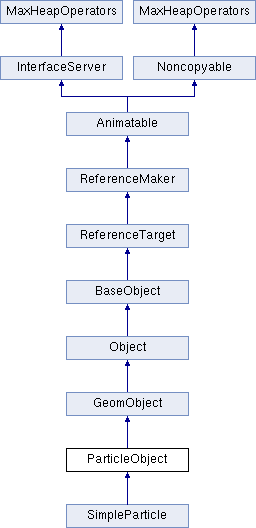

+ Inheritance diagram for ParticleObject:
