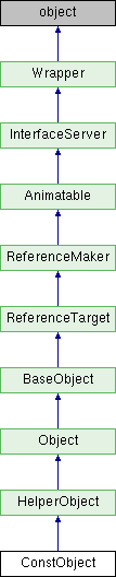

Class Description
A construction grid helper object.
+ Inheritance diagram for ConstObject:
