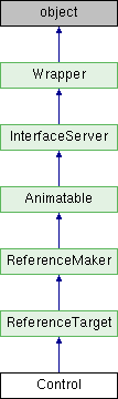

The base class of animation controllers. Controllers generate values at different points in time using keyframes or other methods.
