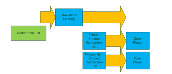

  1. The render item is specific to a display mode (for example, wireframe versus shaded/textured modes). It is important to note that the display mode is matched against the current display modes used for rendering and suitably filtered out as necessary. For example: a shaded mode item is not drawn when the viewport is in wireframe mode.
    Figure 78
    A basic pipeline showing how draw mode filtering can potentially remove items from proceeding to the draw phase. This generally supersedes any filtering that is based on whether an item is considered to be “shaded” or “non-shaded”.

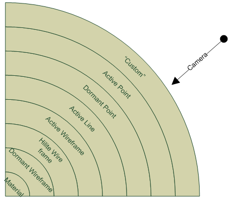

  5. The depth priority needs to be different.
    Figure 79
    Logical illustration of the effect of different depth priority settings that move the render item towards the active camera. “Custom” priorities can be used instead of stock ones. The arrow shows the direction of the camera (viewer).

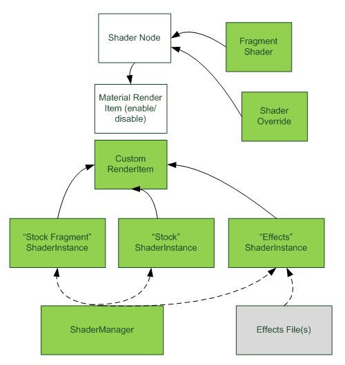

Choosing shaders and shader instances
The options for choosing a shader for a render item can vary in complexity and application. Regardless of which option is chosen, it is best to separate shaders from geometry handling.
The simplest option is to use stock shaders provided via MShaderManager. These provide default configurations for shaders that can be used for point, line, and triangle UI drawing, as well as a few stock material shaders. Stock shader instances are specific to the primitive type; for example, a dashed line shader would be inappropriate for rendering triangles.
Using custom effect file shaders is also possible for greater control but requires implementations for all draw APIs (for example, DirectX11, and OpenGL). One reason for using custom shaders is to have a more complex set of parameters that can allow for dynamic updates as opposed to a larger set of static render item variants.
Fragment based shaders are best suited for integration with Maya's shading networks and are not recommended for UI drawing. Using built-in fragments is a simple way to get full shading and lighting support.
For the most flexibility, shaders should not be owned and controlled by geometry overrides but instead separate MPxShaderOverrides should be used. Thus geometry overrides are geometry handlers and shader overrides are material handlers.
Each shader has a set of parameters and geometry requirements associated with it. Each instance of a shader has different shader parameters and/or requirements, resulting in different render items for each shader instance.
Depending on the frequency of updates, it may be easier to attach callbacks to MShaderInstances for parameter updating. For example, this would allow changing the thickness parameter of a line shader during a callback, as opposed to creating two separate shader instances (hence render items) with different line thickness parameter values.
In the case where different streams are bound to the same set of geometry requirements, different shader instances are not required, as geometry binding is performed dynamically.

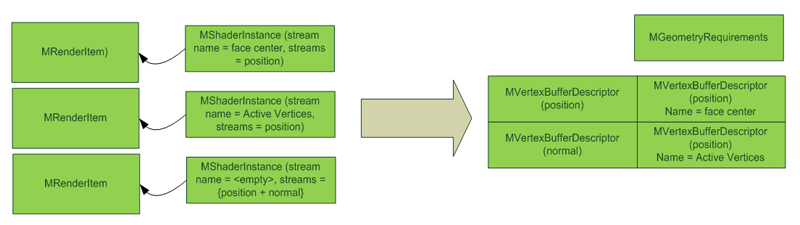

Custom render items are named and thus there is a set of named render items to manage. There is also the possibly of the requirement for geometry streams of the same semantic but with different names.
For example, two streams of positions (semantic) may be required for the case where a material render item draw and a render item that draws face normal are required. The first could be named “My shaded item” and the second “My face center item”. The latter could call MRenderItem::setShader() with a custom stream name of “face center”.
Additionally, as no explicit association is given between streams and render items, it can sometimes be useful to name streams if it is required that they be used for specific custom render items. There are trade-offs, as each named stream may result in additional geometry data and indexing allocation being required. Also, geometry updates must handle the fact that stream naming is per render item. That is, it applies to all streams for an item. An example usage is given in 4.4.5.5 Basic component handling.
Figure 80
The figure above shows three render items on the left. The top-most item is for drawing face centers. It requires only positions and has a custom name of "face center". Next is an item to draw active vertices and requires positions and has a custom stream name of "Active Vertices". The last is a material render item which requires positions and normal. There are no custom names. When the final cumulative set of requirements comes back for which the override must provide geometry, there are descriptions for 4 streams of data required (MVertexBufferDescriptor): 3 position streams and one normal stream. The position streams could be shared for material and active vertex display.
No assumptions should be made as to when data is required, and as such, all requirements should always be fulfilled. The renderer may attempt to provide some default data if the appropriate data is not provided, but there is no guarantee that the appropriate data can be provided. For example, one viewport panel may require the data for a wireframe render item in addition to a shaded one if the viewport configuration has one panel in shaded mode and the other with wire-on-shaded mode enabled. The shaded render item may require tangents to be provided.

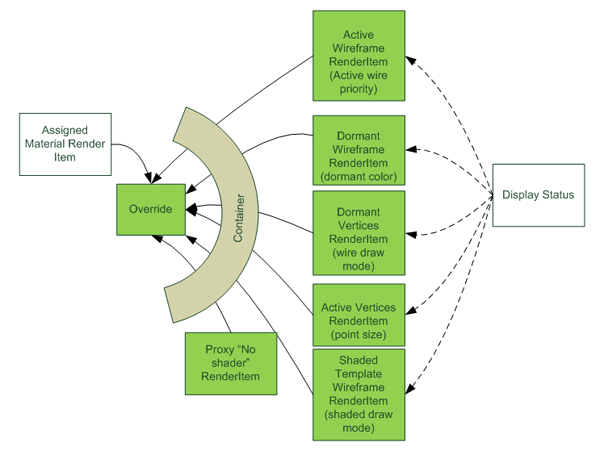

Custom UI drawing example
As an example, a plug-in can create custom render items for the following:
Figure 81
Green boxes represent areas that the plug-in would create and manage. White boxes are provided by the renderer.
The following are example parameters of the items illustrated above and their proposed update frequency:
The crescent “container” shows how logically both geometry and subscene override render items are collected into a set of render items. The main difference is that subscene override container classes are explicitly exposed in the API.

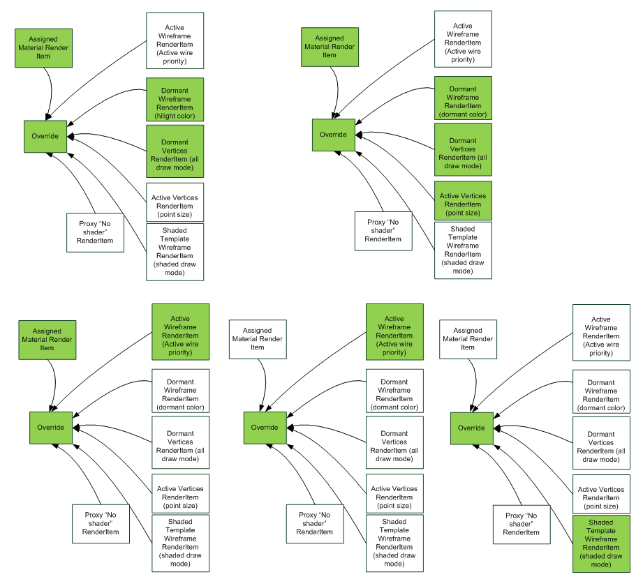

The following are some example user workflows and how the plug-in could handle their render items:
  1. User goes into component selection mode while in shaded mode:
    1. The object is in highlight mode so the dormant wireframe item should be enabled and the color set appropriately.
    2. The dormant vertex render item should be enabled and the color set appropriately.
    3. The active wireframe item should be disabled.
    4. The active vertex item should be disabled.
    5. The shaded template item should be disabled.
    6. The shaded proxy item should be disabled.
      Note:
      The material shaded item is enabled internally, and was enabled when entering into shaded mode.
  2. The user then selects some vertices:
    1. The active vertex item should be enabled. The active components should be parsed to set the appropriate indexing to show a subset of vertices.
  3. The user switches back to object selection mode:
    1. Dormant and active vertex items are disabled.
    2. Active wireframe item is enabled.
    3. The dormant wireframe item is disabled.
  4. The user switches to wireframe mode:
    1. “Nothing” needs to be done in the plug-in as the render items marked to draw in shaded mode are filtered out in the draw pipeline.
  5. The user sets the object override to make the object template:
    1. If there are any custom material render items, they should be disabled. Provided material render items are automatically disabled.
    2. The dormant and active wireframe items should be disabled.
    3. The dormant vertex item should be disabled.
    4. The shaded template item should be enabled and set to the appropriate color depending on whether or not the object is active.
Figure 82
From top to bottom, and left to right are the five actions listed above, shown graphically. At all times, all the render items are retained with basic enabling and disabling occurring as well as possible parameter changes such as color. Items in green are enabled while all other render items are disabled.
For geometry overrides, the majority of the handling is done in updateRenderItems(), for sub-scene overrides in update(). The SDK plug-in apiMeshShape contains example code which contains logic to support workflows like the above, as well as many “standard” workflows.

If custom material rendering is required, then the level of integration is dependent on the interfaces that are used. The following table outlines the main trade-offs associated with each interface. Increased flexibility generally requires more work to be done by the plug-in writer. To a certain extent, simpler shaders can be maintained inside the geometry handler/override.
Fragment, Effects, and Stock are options available via the shader manager, and hence supported options are determined by the internal renderer. Shader Override is MPxShaderOverride.
 Fragment ShaderEffects ShaderStock ShaderShader Override
Flexibility : Complexity ratioHigh : HighMedium : LowLow : LowHigh : High
Use case
Generally used to enhance the set of existing fragments.
Can be used as “stock” shader but more complex to set up appropriate shading network.
All internal semantic bindings supported.
Self-contained effect which can use default semantic bindings.
Simple built in effect is “good enough”.
Useful when plug-in does not want to deal with writing complex UI shaders to replace any previously easy-to-write fixed-function code.
Complex shading support is required beyond what the internal renderer can provide; for example, tessellation shaders.
Render item “type”Custom.Custom.Custom.Non-Custom.
Shading graph support
If using individual fragments, none.
If the fragment shader is used in a node as part of a Maya shader tree, then it is fully integrated. If the fragment shader is used to create an MShaderInstance then there is no explicit support.
None.None.Plug-in determined.
Lighting supportIntegrated.No automatic binding.Ignored by design.Plug-in binds via access to draw context.
Post effects supportIntegrated.Not integrated.Ignored by design.Plug-in provides techniques to support various passes required by effects.
Draw API SupportIf custom, requires implementation for each draw API, otherwise API agnostic.Plug-in writer writes versions for APIs to support.Built-in.Plug-in writer writes versions for APIs to support.
Shader stages supportedVertex, Pixel.Vertex, Pixel, Geometry.Not exposed.Determined by plug-in.
Separation from geometry handler (override)Can be used for shader instances on render items created by geometry handler.Can be used for shader instances on render items created by geometry handler.Can be used for shader instances on render items created by geometry handler.Independent from geometry handling.

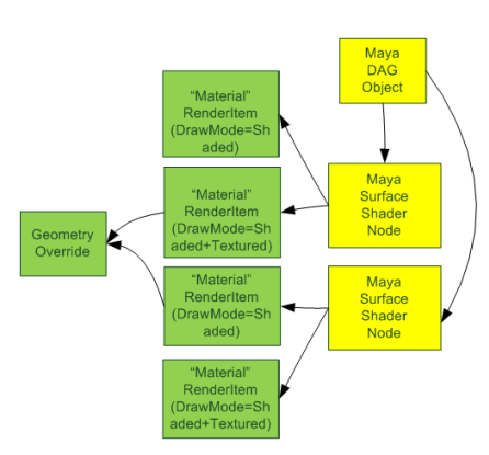

When dealing with material items, there are generally render items that have “shaded” or “shaded and textured” draw modes being passed to an override. There can be 0 or more sets of these passed in, depending on the number of materials that are assigned to the DAG object.
Figure 83
In this example, a DAG object has 2 shaders assigned to different components on the DAG object. It is possible to have 4 “material” render items: one for each component shader to draw in “shaded” draw mode, and one for each component shader to draw in “shaded and textured” mode.
Parameters on these render items can be used as is, modified, or they can be disabled. If disabled, then the plug-in is responsible for providing replacements. If no replacement is provided, then the object appears to “disappear” when in shaded and/or textured modes. Depending on the type of replacement, different levels of integration may result.

Custom renderable creationMDrawInfo::getPrototype()MRenderItem::Create()
Custom renderable deletionDraw requests are transient and released internally every refresh.MRenderItem::Destroy()

Material handlingTemplate fixed function material provided. Can be overridden at will.
MShaderInstance based. Parameters modifiable at update time. Shader binding (rebinding) to render items possible.
More complex / decoupled material handling should be done via MPxShaderOverride.
Display Mode HandlingDisplay mode is provided as input and can be ignored at will.Draw modes are intrinsic part of a render item. Internal logic prune items based on display mode membership.
Geometry Requirements InterfaceNo concept.
MPxGeometryOverride::populateGeometry()
MPxSubSceneOverride::setGeometryForRenderItem()
Geometry Requirements FillingNo concept.Explicit stream naming possible for different render items resulting in additional buffer and index handling.

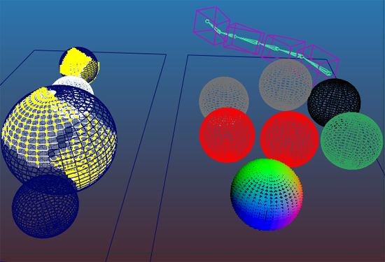

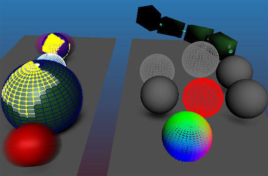

Sample code
The apiMeshShape developer kit example takes into account a number of workflows related to UI handling as well as for proxy shader handling.
Figure 85
apiMeshShape sample scene in wireframe mode.
Figure 86
apiMeshShape sample scene in shaded mode.
The above snapshots demonstrate a number of different custom render items being used. All objects except the planes and the IK chain are drawn using the same plug-in. Included are:
Sample code for active wireframe handling
The following code demonstrates the handling of an “active wireframe” render item from within MPxGeometryOverride::updateRenderItems(). The code logic would be similar if used with MPxSubSceneOverride, except that the render item would belong to the container (MPxSubSceneContainer) instead of an MRenderItemList.

During updateRenderItems(), a new “active” wireframe item is created if it does not already exist. If a new wireframe is created, then the draw mode is set to “all” modes and the item is set to draw above any shaded render item.

    selectItem->depthPriority( MHWRender::MRenderItem::sActiveWireDepthPriority);

Based on the display status, during each update, the color for the wireframe item is updated. It switches colors based on statuses such as lead, active, highlight, and active-component.

Sample code for active vertex handling
The following is sample code for handling of an “active vertex” render item from within MPxGeometryOverride::updateRenderItems(). There is a separate utility method which checks display status to determine whether or not the component render item should be disabled.
The test also considers if there are any active vertices, which is determined during DG update time (updatedDG()).
Note that this code path has been written to allow for named streams to be used. Inside the populateGeometry() method, these named streams can be checked and a different set of positions can be used to draw active vertices with.

During updateRenderItems(), the appropriate item is created as needed to draw in "all" modes. The depth priority is set to avoid being obscured by dormant vertices and any wireframe items. The item is enabled based on whether or not components should be displayed.

    // Set depth priority to be active point. This should offset it
    // to be visible above items with "dormant point" priority.
    activeItem->depthPriority( MHWRender::MRenderItem::sActivePointDepthPriority );

The following is part of the code logic for handling the custom named stream in populateGeometry(). The key part of the code is the checking of the vertex buffer descriptor name to see if it matches the name set when calling MRenderItem::setShader() during updateRenderItems() above. The plug-in is then free to fill in the data, and create the appropriate indexing structure for the render item with the name matching the value stored in the variable: fActiveVertexItemName.
const MHWRender::MVertexBufferDescriptorList& descList =
        requirements.vertexRequirements();
int numVertexReqs = descList.length();
MHWRender::MVertexBufferDescriptor desc;
for (int reqNum=0; reqNumacquire(
                              activeVertexCount,
                              true
                              /*writeOnly*/
        break;
        default:
            break;
