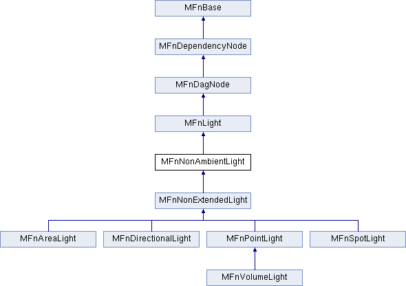

C++ API Reference
Manage Non-ambient Light dependency Nodes. More...
#include <MFnNonAmbientLight.h>
+ Inheritance diagram for MFnNonAmbientLight:

Reimplemented from MFnLight.
Reimplemented in MFnSpotLight, MFnNonExtendedLight, MFnAreaLight, MFnDirectionalLight, MFnPointLight, and MFnVolumeLight.
