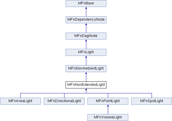

+ Inheritance diagram for MFnNonExtendedLight:
