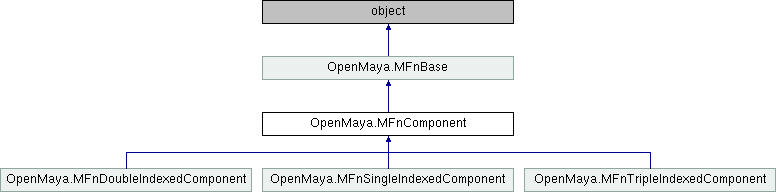

 Inheritance diagram for OpenMaya.MFnComponent:
 Inheritance diagram for OpenMaya.MFnComponent:| Public Member Functions | |
