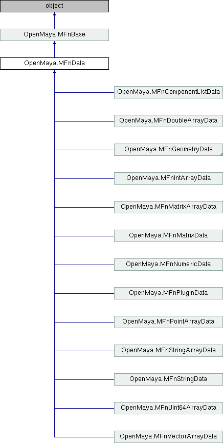

 Inheritance diagram for OpenMaya.MFnData:
 Inheritance diagram for OpenMaya.MFnData:| Public Member Functions | |

Base class for dependency graph data function sets. Method resolution order: - MFnData - MFnBase - __builtin__.object
Base class for data function sets.
