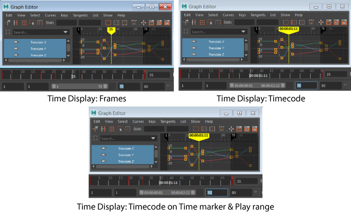

You can set the following preferences in the Time Slider category of the Preferences window.
To return to the default factory settings, choose in this window. Note that this resets the preferences in every category in the Preferences window.
in the lower-right corner of the Maya window.
Frame selections include: 2 fps, 3 fps, 4 fps, 5 fps, 6 fps, 8 fps, 10 fps, 12 fps, 15 fps, 16 fps, 20 fps, 23.976 fps, 24 fps (Film), 25 fps (PAL), 29.97 fps, 29.97 df (drop frame), 30 fps, 40 fps, 47.952 fps, 48 fps (Show), 50 fps (PAL Field), 59.94 fps, 60 fps (NTSC Field), 75 fps, 80 fps, 100 fps, 120 fps, 125 fps, 150 fps, 200 fps, 240 fps, 250 fps, 300 fps, 375 fps, 400 fps, 500 fps, 600 fps, 750 fps, 1200 fps, 1500 fps, 2000 fps, 3000 fps, 6000 fps, 44 100 fps, and 48 000 fps.
By default when you change the current time unit, the times for any existing keys are modified so that playback timing is preserved. For example, a key set at frame 12film changes to frame 15ntsc when the current time unit is changed to NTSC, since they both represent a key at 0.5 seconds. When this option is on, it leaves the key at 12ntsc that was originally at 12film. The default setting for this option is off. The option turns on once the current Time unit is changed above.
Specifies playback range start and end times. The playback start and end times specify the Time Slider playback range. The playback range is always within the animation range. You can also specify the time units. See Edit animation preferences.
Specifies animation range start and end times. The animation start and end times specify the Range Slider range. The playback range always stays within the animation range, so changing the animation start and end times can also change the playback start and end times. Default animation start time is 1.00. Default animation end time is 48.00. You can also specify the time units. See Edit animation preferences.
Specifies the Time Slider height (the vertical space it occupies). Increasing the height is especially useful when you are working with sound. Double or quadruple the height for a better display of sound waveforms. Click 1x (normal height), 2x (double height), or 4x (quadruple height). Default is 1x.
Specifies how the line markers that indicate keys appear on the Time Slider. Click None, Active, or Channel Box. Default is Active.
Specifies that key ticks are not displayed. Selecting None is useful if you have a lot of keys and want to improve workspace selection performance.
Specifies that key ticks are displayed, with associated keys available for selection and editing.
Specifies that key ticks appear only for the currently selected channels in the Channel Box. This is useful if you are using the Time Slider to edit keys on particular channels of an animated object.
Allows you to switch between displaying all key ticks and key ticks associated with specific channels.
Change the thickness of ticks that represent keyframes in the Maya Time Slider. Key thickness is measured in pixels. Click 1x (default width), 2x (double width), or 3x (triple width).
When on, synchronizes your selections in the Channel Box to the Time Slider so that the Time Slider displays only keys for those selected channels. When you set a keyframe (press S or select Key > Set Key), only channels selected in the Channel Box are keyed. If nothing is selected in the Channel Box, the Time Slider displays keys for selected objects as usual.
When on, synchronizes your selections in the Channel Box to also display in the Graph Editor. If no channels are selected in the Channel Box, the Graph Editor displays curves for selected objects as usual.
When you activate Snapping On, Maya steps through animation times by integer values, snapping to the nearest integer. The default is On. If working with sound or small time ranges, you can turn off Snap to whole frames for smoother scrubbing.
Specifies the speed at which your scene plays. Select Play Every Frame, x 1, x 0.5, x 2, using the frame rate set in the Working Units section of the Settings preferences. The default is Real-time (30 fps).
You can also specify the playback time units. See Edit animation preferences.
When selected, all the frames in your scene play, updating each before displaying the next. The speed depends on how long it takes your workstation to compute and draw each frame. You can specify the playback frame increment in the Playback by field. For example, a Playback value of 2.0 plays only every other frame.
When selected, your scene plays at the frame rate set in the Working Units section of the Settings preferences. (The default fps is Maya is 24 frames per second). Maya LT may not display all frames, depending on your workstation’s capabilities, the scene’s complexity, and the display mode (for example, wireframe or smooth shading).
When selected, your scene plays at half the speed set in the Working Units section of the Settings preferences.
When selected, your scene plays at twice the speed set in the Working Units section of the Settings preferences.
When selected, your scene plays at the custom playback speed specified with the Other Speed setting.
Available only when Playback Speed is set to Other.
Let you set a custom playback speed (in frames per second) for your scene. For example, if you specify an Other Speed value of 72, animation plays back at 72 fps.
Specifies playback increments if Playback speed is set to Play Every Frame. For example, if you enter 4, Maya plays only every fourth frame (or time). Default is 1.000. You can also specify the playback time units.
Lets you clamp the animation playback speed by specifying a value the speed cannot exceed.
Specifies no Max Playback Speed.
Specifies that the overall playback speed of your scene’s animation is as fast as possible, but it does not exceed 30 fps.
Specifies that the overall playback speed of your scene’s animation is as fast as possible, but it does not exceed 15 fps.
Specifies that the overall playback speed of your scene’s animation is as fast as possible, but it does not exceed 60 fps.
If your workspace layout includes several views (for example, selected from Panels > Layouts), you can improve performance by having the scene play in only the currently active view. Click Active or All. Default is Active.
Scene plays only in the current, active view.
Scene plays in all the workspace views.
in the
Playback Options, next to the Range Slider.
