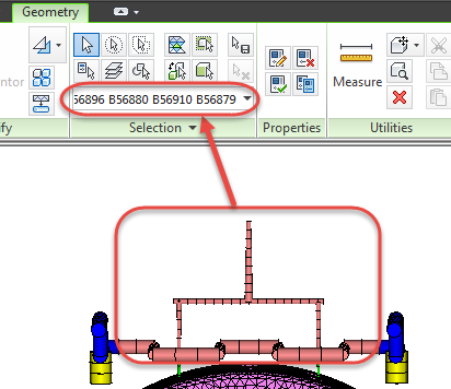

Beam elements
Beam elements are two-noded elements used to represent runner system components, cooling channels, gas channels, and tapered or non-tapered structural beams on the part.
Beam elements are assigned the identification label 'B'. When you select beam elements, the identifiers, which are comprised of the letter B followed by a number, are listed in the selection list.
