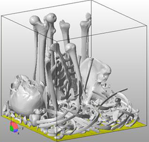

The Scanline packer is best suited to packing a collection of parts that exhibit a wide range of shapes and sizes, such as skeleton bones. During the packing process, the parts rotate as necessary, and according to user-defined settings, in order to find the best orientation to enable more dense packing. With this packer, once you start packing, the calculations continue until they are finished. You either wait until the end, or cancel the process.

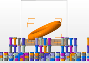

The Monte Carlo packer is best suited to cases that include one or two vital and potentially expensive part(s) that are aligned carefully in the build space, surrounded by many small, less important parts. During the packing process, if allowed by the settings, the parts are rotated at the start, but then not again. The process is similar to random shaking, where parts move into gaps as they find them. The goal of Monte Carlo packing is to move the parts as low as possible in the build space, to minimize the Packed Platform Height.
Place the main part(s) as low to the platform as possible to avoid wasting powder, then lock them in place with the Lock Positions of selected items option. Select all the small parts for packing and start the packer. With the Monte Carlo packer, you can stop packing as soon as you are happy with the result. Or you can resume packing if you want the packer to try again.
Main part locked in build space, with smaller nuts and bolts to be packed around it
Due to how it works, the Monte Carlo packer prevents interlocking problems; during the shaking process the parts bounce off each other rather than packing more densely.
