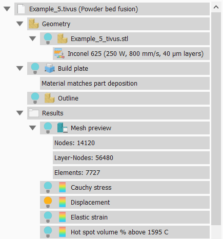

Control the display of parts and simulation results by clicking light bulb icons in the Browser, on the left side of the
Simulation Utility window.
Before running a simulation, you can check the Browser to verify the material and PRM file assigned to the part, and the material for the build plate, if different from the part. After solving a simulation, the Results appear in the Browser. The figure below is only a partial display. Click off the light bulbs (
) to turn off the Geometry, Build plate or Outline display, and turn on (
) one of the Results, such as Displacement, Structure type, Temperature, or a Stress type.

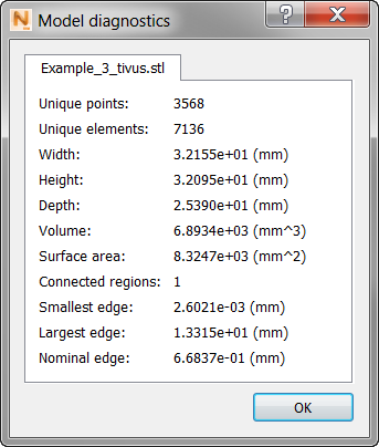

- Diagnostics displays a range of physical data about the model, as in this example:
