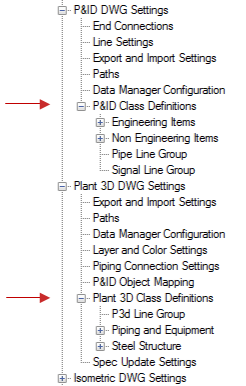

Class definitions are groupings of plant objects and their associated attributes and properties.
The high-level groupings of class definitions for P&ID are the following:
- Engineering Items. Includes equipment, nozzles, instrumentation, inline assets, and lines.
- Non Engineering Items. Includes items that cannot be purchased, or are not counted in reports (including flow arrows, gap, actuators, connectors, annotations, line breakers, and so on).
- Pipe Line Groups. Includes pipe lines.
- Signal Line Groups. Includes signal lines used with instruments.
The high-level groupings of class definitions for Plant 3D are the following:
- P3D Line Group. Includes line groups.
- Piping and Equipment. Includes equipment, pipe run components, and fasteners.
- Steel Structure. Includes structure members, railings, ladders, and so on.
You can modify existing class definitions.
