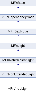

C++ API Reference
Manage Area Light dependency Nodes. More...
#include <MFnAreaLight.h>
MFnAreaLight facilitates creation and manipulation of dependency graph nodes representing area lights.
virtual |
Destructor.
The class destructor.
MFnAreaLight | ( | MObject & | object, |
MStatus * | ReturnStatus = NULL |
MFnAreaLight | ( | const MDagPath & | object, |
MFnAreaLight | ( | const MObject & | object, |
virtual |
Function set type.
Return the class type : MFn::kAreaLight.
Reimplemented from MFnNonExtendedLight.
static |
Returns the name of this class.
Return the class name : "MFnAreaLight".
