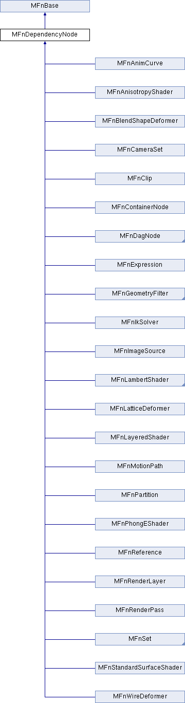

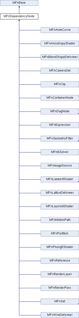

C++ API Reference
Dependency node function set. More...
#include <MFnDependencyNode.h>
+ Inheritance diagram for MFnDependencyNode:
