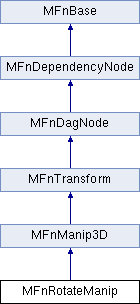

C++ API Reference
RotateManip function set. More...
#include <MFnRotateManip.h>

Return the class type : MFn::kRotateManip.
Reimplemented from MFnManip3D.
