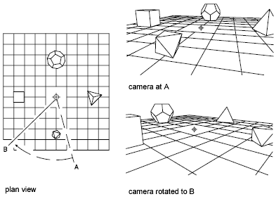

Camera
Specifies a new camera position by rotating the camera about the target point. Two angles determine the amount of rotation.
Camera Location
Sets the camera's position based on the specified point.
Enter Angle from the XY Plane
Sets the camera's position at an angle above or below the XY plane. An angle of 90 degrees looks down from above, and an angle of -90 looks up from below. A camera angle of 0 degrees places the camera parallel to the XY plane of the user coordinate system (UCS).
Toggle (Angle In)
Switches between two angle input modes. Entering an angle at the Command prompt locks the cursor movement so you see only the positions available for that angle. Toggle unlocks the cursor movement for the angle, and you can use the cursor to rotate the camera.
Enter Angle in XY Plane from X Axis
Sets the position at an angle in the XY plane relative to the X axis of the current UCS. This angle measures from -180 to 180 degrees. A rotation angle of 0 degrees looks down the X axis of the UCS toward the origin.
The illustration shows the camera rotating to the left from its initial position, leaving its angle from the XY plane unchanged.
Toggle (Angle From)

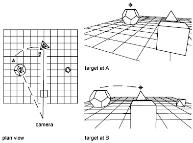

Target
Specifies a new position for the target by rotating it around the camera. The effect is like turning your head to see different parts of the drawing from one vantage point. Two angles determine the amount of rotation.
Toggle (Angle In)
Toggle (Angle In)
The illustration shows the effect of moving the target point from left to right, leaving its angle from the XY plane unchanged.
Toggle (Angle From)
Toggle (Angle From)

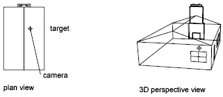

Distance
Moves the camera in or out along the line of sight relative to the target. This option turns on perspective viewing, which causes objects farther from the camera to appear smaller than those closer to the camera. A special perspective icon replaces the coordinate system icon. You are prompted for the new camera-to-target distance.
A slider bar along the top of the drawing area is labeled from 0x to 16x, with 1x representing the current distance. Moving the slider bar to the right increases the distance between camera and target. Moving it to the left decreases that distance. To turn off perspective viewing, click the Off option from the main DVIEW prompt.
If the target and camera points are close together, or if you specify a long-focal-length lens, you might see very little of your drawing when you specify a new distance. If you see little or none of your drawing, try the maximum scale value (16x) or enter a large distance. To magnify the drawing without turning perspective viewing on, use the Zoom option of DVIEW.
The illustration shows the effect of moving the camera along the line of sight relative to the target, where the field of view remains constant.

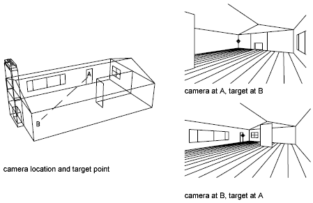

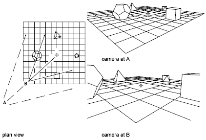

Points
Locates the camera and target points using X,Y,Z coordinates. You can use XYZ point filters.
To help you define a new line of sight, a rubber-band line is drawn from the current camera position to the crosshairs. You are prompted for a new camera location.
A rubber-band line connects the target point to the crosshairs to help you place the camera relative to the target. The illustration shows the change in view as you swap the camera and target points. Lens and distance settings are the same in each case.
For information about entering direction and magnitude angles, see Point Specification.

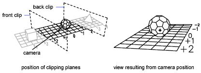

Clip
Clips the view, obscuring portions of the drawing that are behind or in front of the front clipping plane. The front and back clipping planes are invisible walls that you can position perpendicular to the line of sight between the camera and target.
Back
Obscures objects located behind the back clipping plane.
  • Distance from Target. Positions the back clipping plane and turns on back clipping. A positive distance places the clipping plane between the target and the camera. A negative distance places it beyond the target. You can use the slider bar to drag the clipping plane.
  • On. Turns on back clipping at the current clipping distance.
  • Off. Turns off back clipping.
Front
Obscures objects located between the camera and the front clipping plane.
  • Distance from Target.Positions the front clipping plane and turns on front clipping. A positive distance places the clipping plane between the target and the camera. A negative distance places it beyond the target. You can use the slider bar to drag the clipping plane.
  • Eye. Positions the front clipping plane at the camera.
  • On. Turns on front clipping. This option is available only when perspective viewing is off.
  • Off. Turns off front clipping. This option is available only when perspective viewing is off.
Off
Turns off front and back clipping. If perspective viewing is on, front clipping remains on at the camera position.
