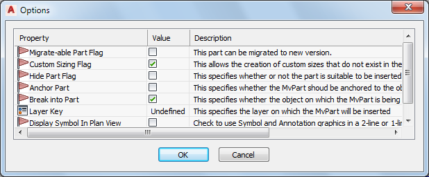

There are other insertion behaviors that you must specify in the Options dialog box, which you can access by clicking
in the Content Builder part browser.
Options dialog box for a parametric MvPart
The following table describes the behaviors (properties) that you can set in the dialog box.
| Property | Description |
| Custom Sizing Flag | Lets you create custom sizes of the part when a needed part size does not exist in the catalog. Custom sizes can be inserted by Auto Layout or by setting part filter/values in the Add dialog box. |
| Hide Part Flag | Hides the part in the catalogs from which you select parts to add to drawings. Note: By default this setting is enabled. Hiding the part is recommended when you are creating a temporary part or creating a part across multiple sessions. However, when you save a part after successfully validating it, the software prompts you to specify whether to continue to hide it.
| Anchor Part | Available for MvParts only. Enables the MvPart to anchor to another object. |
| Break Into Part | Available for MvParts only. Enables the MvPart to break into another object. |
| Layer Key | Available for MvParts only. Specifies the layer to which the MvPart is added in drawings. When you add a fitting to a drawing, the layer to which the fitting is added is determined by the objects to which it is connected. |
| Display Symbol in Plan View | Available for MvParts only. Specifies whether to display the schematic symbol of the part instead of a model-generated view in 1-line and 2-line display representations in Top (plan) view. |
| AutoLayout Flag | Available for fittings only. Adds autolayout data to the fitting in the part browser, which enables you to specify trim lengths and a placement point. The software automatically adds autolayout data to MvParts. |
