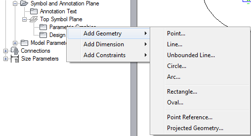

To access the necessary commands, expand Symbol and Annotation Plane, right-click Parametric Graphics, and use the commands on the context menu, as follows. Click Add Geometry, and then click Point Reference.
Symbol and Annotation Plane context menu

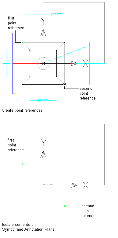

As an example, the following illustrations show how to create a parametric schematic symbol for an air diffuser. First, to align the edges of the symbol with the edges of the diffuser, point references are created on the Symbol and Annotation plane using 2 of the corner points on the diffuser. Then, for better viewing, the contents of the Symbol and Annotation plane are isolated. At this point, the 2 point references are the only geometry on the plane.

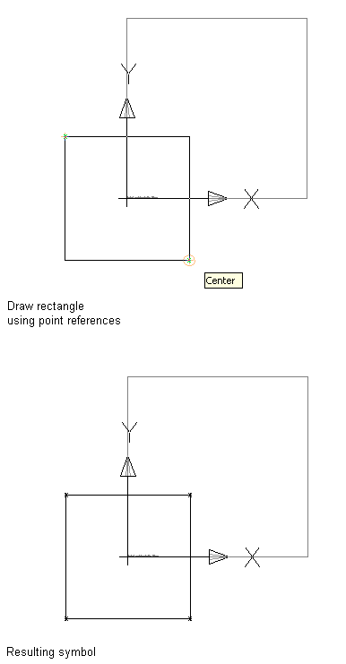

Next, using the point references to specify the corner points, a rectangle is drawn to represent the schematic symbol.
Finally, to cause the symbol to scale proportionally with the diffuser, the corner points of the symbol rectangle are constrained to the underlying point references. Because the point references are based on the corner points of the model, this ensures the symbol and the model remain aligned. You can also accomplish this by adding dimensions to the symbol and setting their values to the names of the corresponding model dimensions. This ensures the symbol dimensions change when the model dimensions change.
